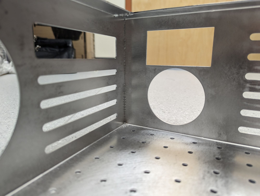

At Protocase, we use Cold Metal Transfer (CMT) welding. While it appears similar to wire-feed MIG welding, there are differences.
In MIG welding, filler metal transfers via sputtering at very high temperatures.
In CMT, the wire is heated enough to melt the tip, and transfer occurs by physical contact. This method generates just one-tenth of the heat of MIG welding, which prevents warping or melting back, even for thin sheet metal.

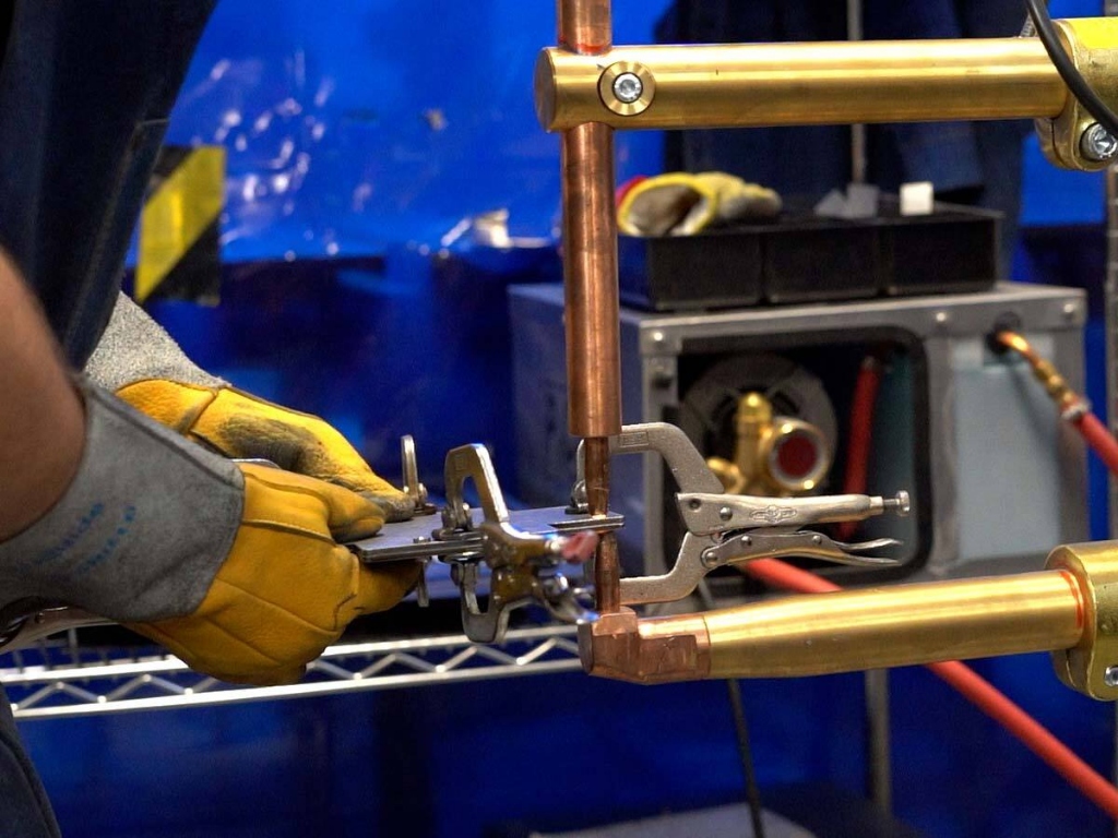

Both spot welding and seam welding are standard processes that are a part of our fast 2-3 day manufacturing lead time.
