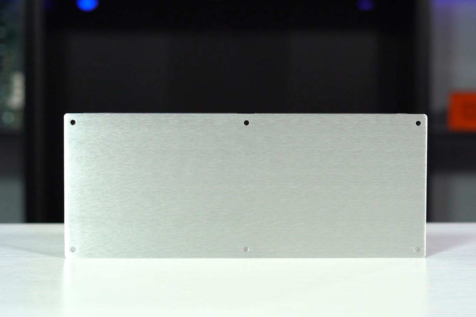

Grained Finish
  • Part is deburred, and then given a specific linear grain direction via brushing.
  • Aesthetically superior option for bare finish for parts or enclosures that will be displayed.
  • Recommended on stainless steel and aluminum (scroll down for more information).

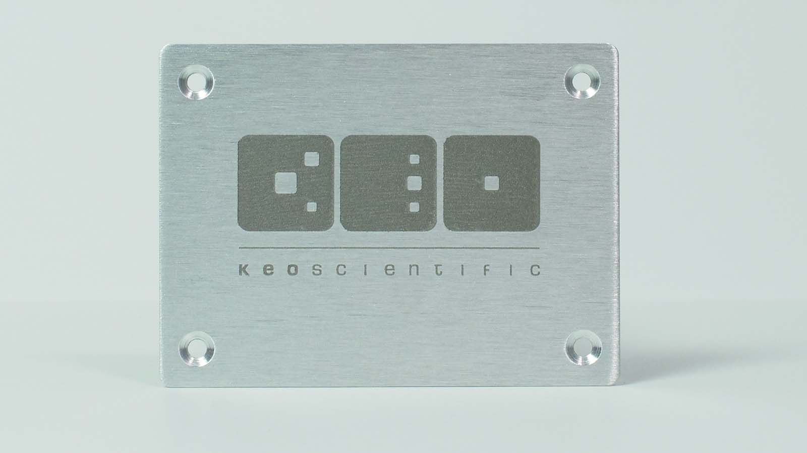

Grained Finish with Laser Marking

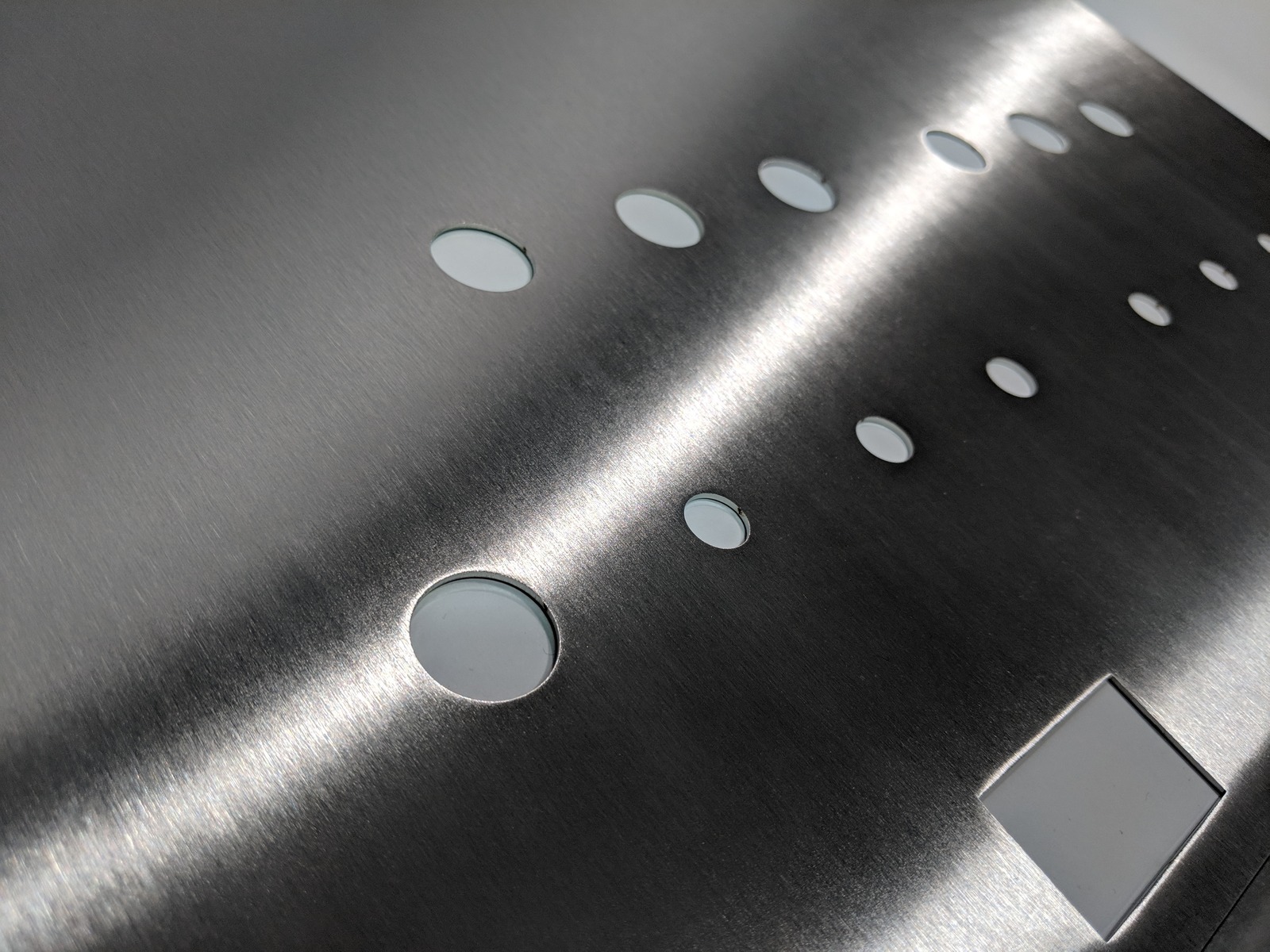

#4 Finish with Cutouts

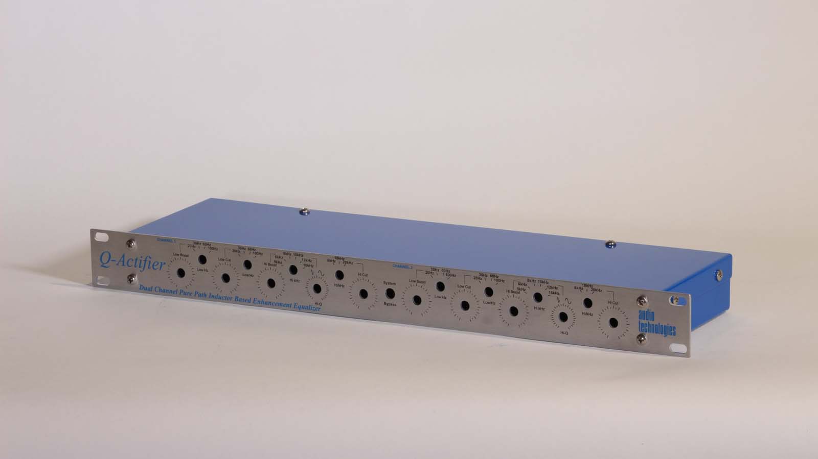

Front Panel with Silkscreen

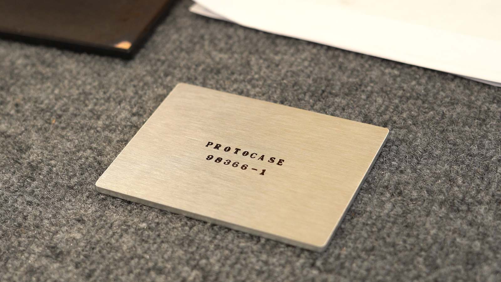

Grained Finish Rubber Stamping
