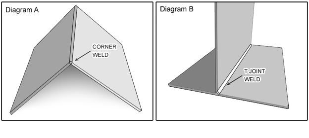

Corner seams (see diagram A below) are geometrically stable. Stresses from temperature change and solidification are countered by the support offered by both edges of the joint. Most corner geometries can be fully seam welded without warpage using CMT welding. This is true for all metal that we stock.
T joints (see diagram B below): Seams that join the edge of a part to a flat surface are prone to warping, because there is no geometric support to counter stresses from temperature and solidification of the base metal. Thus, even with CMT welding, if one makes a long seam weld across the part, it is possible that the flat surface will no longer be flat after welding. This is especially true with stainless steel and aluminum. One solution that can work in certain situations is to join by welding a number of short segments, rather than making a continuous seam. This can leave sufficient unmodified base metal to give the part enough integrity to retain flatness. If you require a T-weld geometry, our technical staff can help you with the design.
Other weld geometries need to be addressed on a case-by-case basis. Contact our technical staff.
