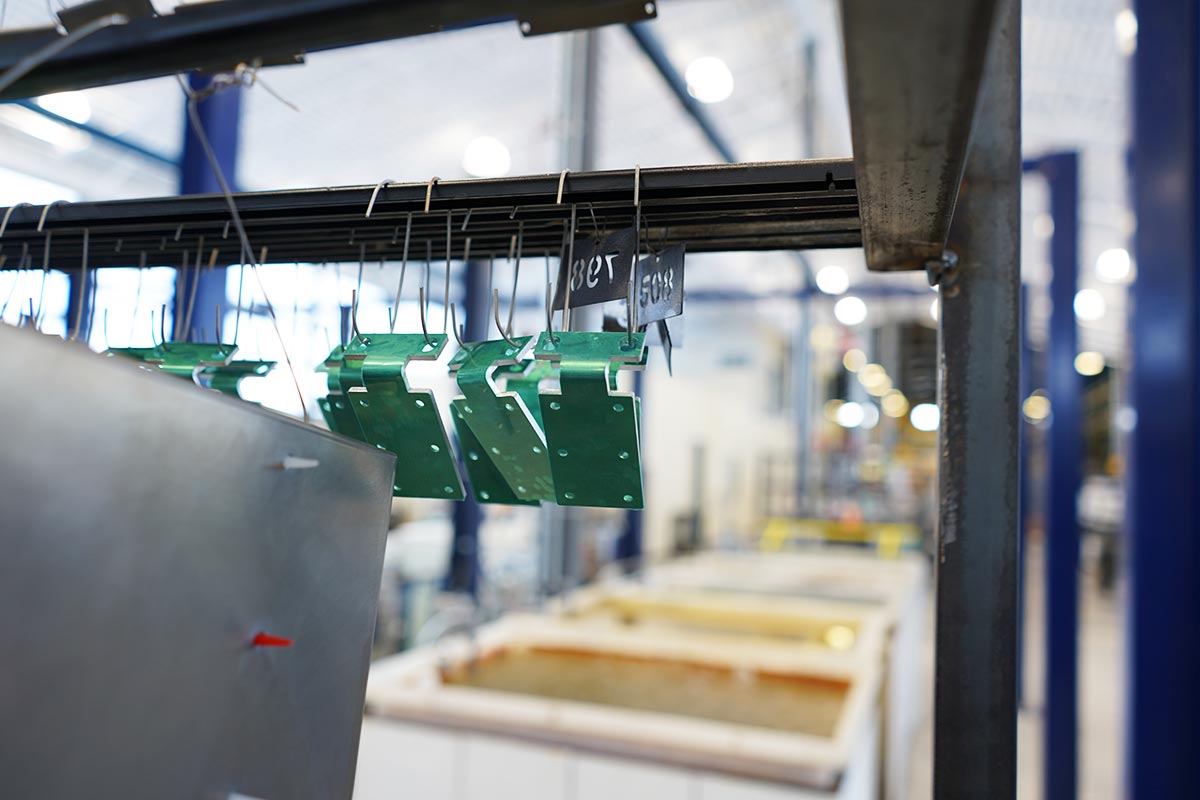

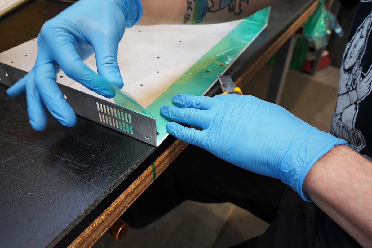

To mask areas of parts, our production team will apply a polyester tape over the areas requiring masking. We can apply rectangular, circular, or CNC cut masking profiles.
We offer full-service masking as a process, in order to keep certain areas of your enclosure, part or panel free from having powder coat paint or anodized finish applied.

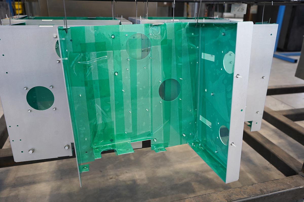

Masking is possible on most areas of an enclosure or part. The most frequently requested applications are:
  • Entire inside of an enclosure
  • Mating surfaces of an enclosure
  • Areas surrounding connector cutouts
  • Areas under electrical components

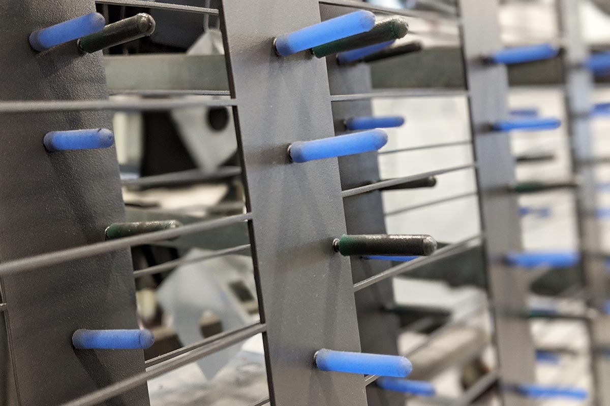

As a rule, we mask all internal and external fastener threads using silicone caps and plugs.
