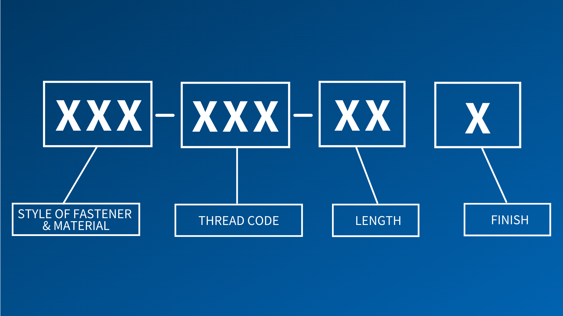

The breakdown of a self-clinching fastener name
Pictured above is a diagram of how each self-clinching fasteners name is broken down. Starting off in the left box is the style of fastener & material, in the middle is the thread code, followed by the length and finish.
