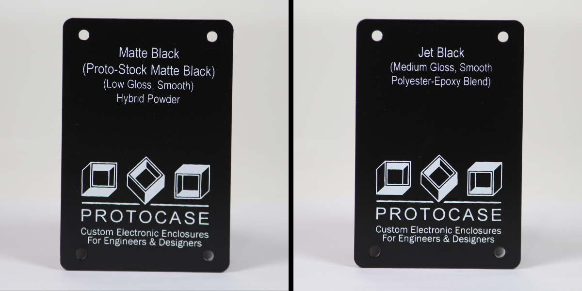

Black Powdercoat Option #1 – Proto-Stock Matte Black
Type: Low Gloss, Smooth Hybrid Powder
Parts with Proto Stock Matte Black and RAL 9005 Jet Black
Comparison between Proto Stock Matte Black and RAL 9005 Jet Black
Our Proto Stock Matte Black is a popular option, and a solid substitute for RAL 9005 Jet Black. This powdercoat is actually slightly less glossy compared to RAL 9005 Jet Black, but has an equal smoothness to it.
Proto Stock Matte Black is a hybrid powdercoat, meaning it is a blend of polyester and epoxy powder. Since RAL 9005 Jet Black is also a polyester-epoxy blend, the two powdercoats have a similar makeup.
PROS:
  • Equal smoothness
  • Similar makeup to RAL 9005 in terms of epoxy-powdercoat blend
CONS:
  • Will reflect less light than RAL 9005 Jet Black
  • Could be susceptible to fingerprints, especially if it’s handled often

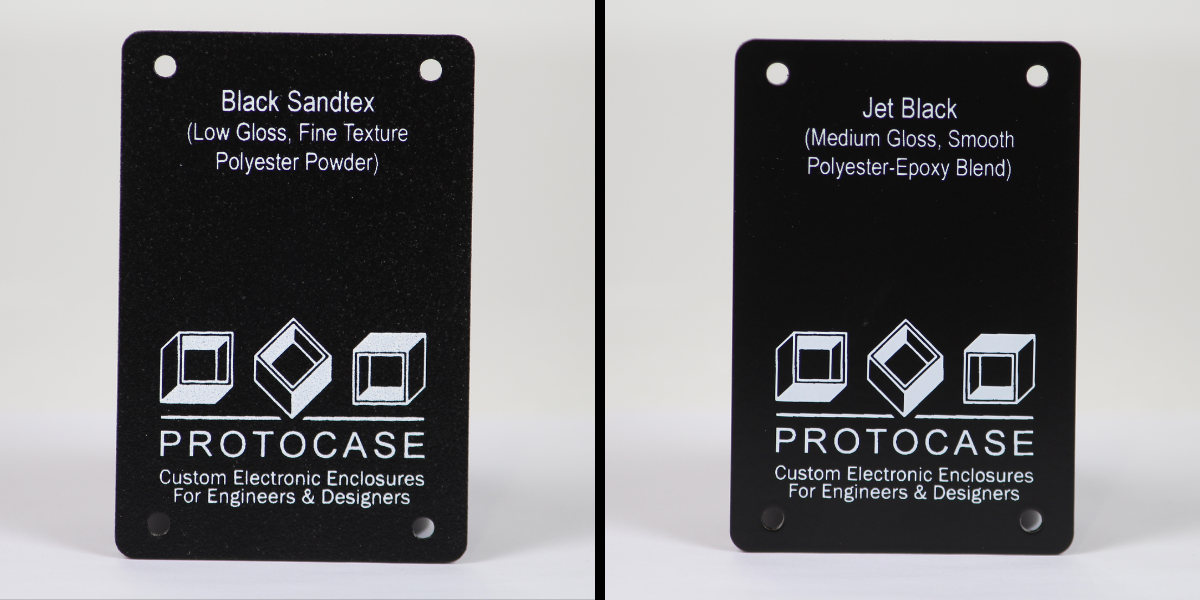

Black Powdercoat Option #2 – Black Sandtex
Type: Low Gloss Fine Texture Polyester Powder
Parts with Black Sandtex and RAL 9005 Jet Black
Comparison between Black Sandtex and RAL 9005 Jet Black
Black Sandtex is a pretty stark change from RAL 9005 Jet Black, as a sandtex powdercoat has a textured feel that is both visible to the eye and felt by touch. Sandtex powdercoat is an excellent option if your application requires durability and toughness.
Plus, a sandtex powdercoat tends to hide blemishes much better than other powdercoat textures. (For example, if your enclosure or parts include welding, a sandtex powdercoat is your best bet).
Sandtex powdercoats like Black Sandtex can be more difficult to clean, due to the textured surface.
PROS
  • Very durable
  • Sandtex hides blemishes very well
CONS
  • Harder to clean

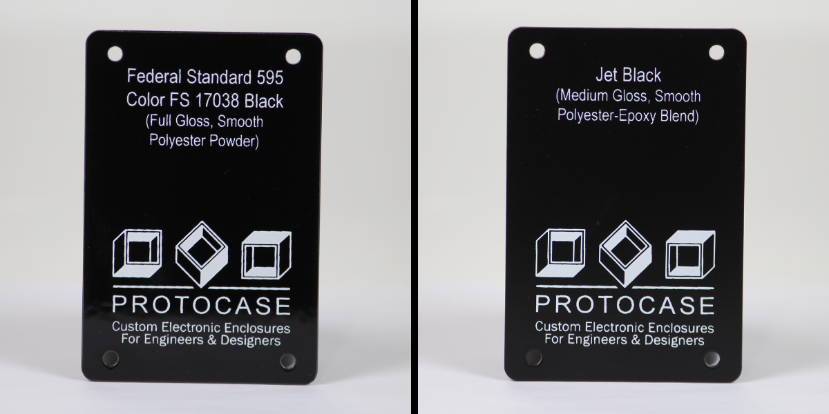

Black Powdercoat Option #3 -FS 17038 Black
Type: Full Gloss Smooth Polyester Powder
Parts with Federal Standard 595 Color FS 17038 Black and RAL 9005 Jet Black
Comparison between Federal Standard 595 Color FS 17038 Black and RAL 9005 Jet Black
FS 17038 Black is a much glossier option compared to RAL 9005 Jet Black, as it is a full gloss polyester powdercoat. This means that it will reflect more light compared to RAL 9005’s medium gloss.
One other caution – FS 17038’s full gloss means it is much more susceptible to fingerprints and smudges. These can be buffed out with a non-abrasive cloth, but something to keep in mind if you are seeking a matte finish that won’t easily smudge with fingerprints.
PROS:
  • Very easy to clean
  • Federally rated black powdercoat
CONS:
  • Much glossier option
  • More susceptible to fingerprints

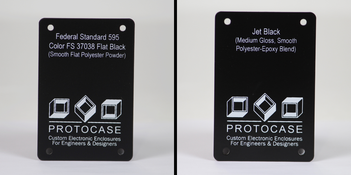

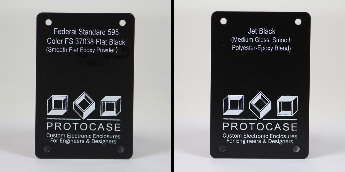

Black Powdercoat Option #4 -Federal Standard 595 Color FS 37038
Type: Flat Black Flat Smooth Epoxy Powder
Parts with Federal Standard 595 Color FS 37038 Flat Black and RAL 9005 Jet Black
Comparison between Federal Standard 595 Color FS 37038 Flat Black and RAL 9005 Jet Black
Of the four stocked black powdercoat options available, Federal Standard 595 Color FS 37038 is perhaps your best substitute for RAL 9005 Jet Black, as it is fairly matte and flat finish.
FS 37038’s polyester powder will also offer you some extra durability and resistance, which makes it a better option for exterior applications.
PROS:
  • Close match to RAL 9005 Jet Black in terms of matte/flatness
CONS:
  • Not a polyester-epoxy blend like RAL 9005 Jet Black
