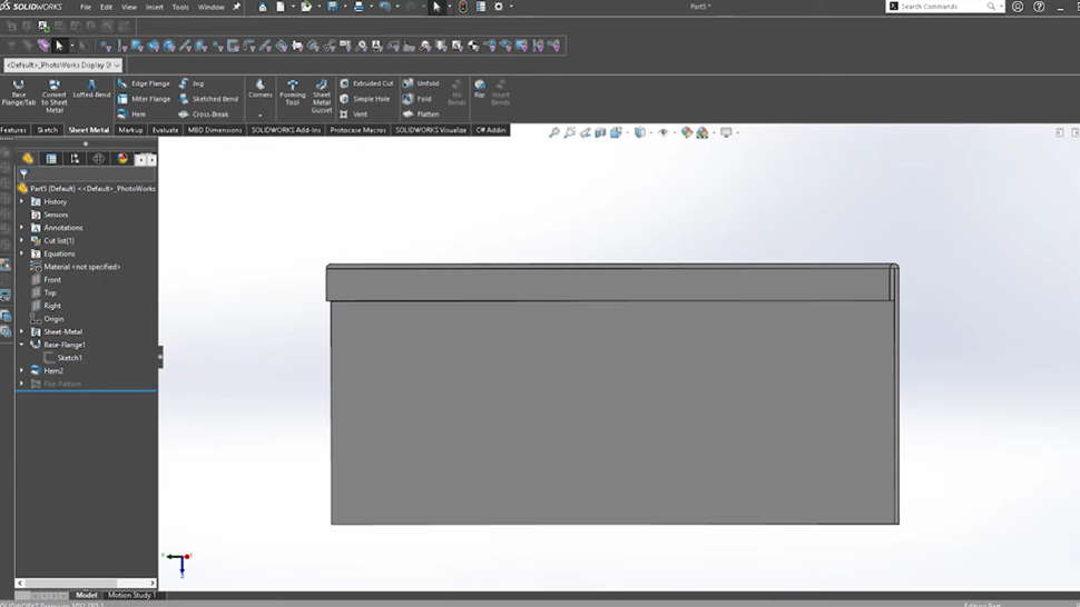

Hem bend design on CAD software - a key way you can add strength to a sheet metal part
Adding a hem bend to your design can add strength to your sheet metal part
A hem bend is essentially a piece of material that is folded over 180° on top of itself. The cut edge by itself may be easily twisted, but sandwiching two pieces on top of each other doubles up the strength and helps prevent that twisting motion.
Hem bands can especially be useful if you’re worried about parts of your sheet metal being unstable or slack. This process helps the edges remain straight and will reduce flexing.
While creating hem bands, you should ensure that you have a minimum hem bend length of 0.5″ so that the material can flatten on top of itself. Also, make certain that hem bends are placed in accessible areas and not where it will be impeded by any surrounding geometry.

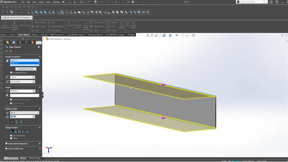

Angle bend design on CAD software - an option for adding strength to sheet metal parts
Adding an angle bend to your design can strengthen your sheet metal parts
If you do not want a 180° bend, you can add an angle bend to add strength to your sheet metal. This simple act of bending will help prevent that part from twisting out of shape.

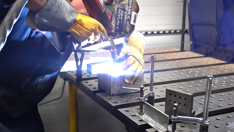

Adding welding into your design can be beneficial in adding strength to your material in a few different scenarios.
For one, if your part’s material is too thick for a hem bend, you can opt for a thin strip of the metal to be cut and spot welded it to the edge of a part. Think of it as a welded hem.
A welder performing plug welding - one of the ways to add strength to sheet metal parts
Behind the scenes of the welding process – one of the ways to add strength to sheet metal parts
Another option: a welded gusset. While gussets can be any profile or shape, they are most typically triangular. Gussets are welded into the seam of an enclosure or part, most often plug welded to both faces. This can ensure that your underside of your part or enclosure’s bend has that extra bit of support to prevent it from bending further.
