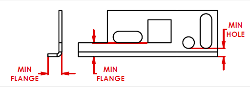

Minimum Bend Dimension
Geometry of tooling imposes a minimum bend dimension. The diagram shows one such mechanism. Refer to the chart for values for folder as well as various press brake tooling combinations.
Tip: Use the minimum bend dimension values in the charts below for your minimum closeness of cutout to a bend.
Minimum Flange and Minimum Hole
We’ve broken down our minimum bend size into two values: minimum hole distance and minimum flange distance.
Minimum hole distance specifies how far a hole must be placed from the bend radii to ensure it will not warp. Minimum hole distance applies only for round holes and rounded slots oriented perpendicular to the bend radii.
Minimum flange is the minimum distance that the edge of a flange, or particular types of cutouts (rounded slots parallel to the bend, rectangular or oval-shaped cutouts) can be outside of the bend.
Min Hole vs Min Flange diagram
Refer to the material tables below for minimum flange and minimum hole values.
