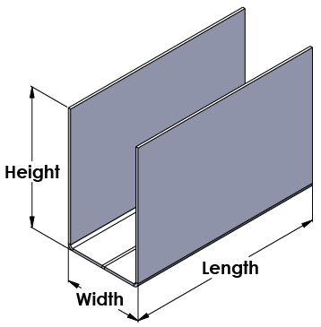

W Bends
![W Bends](img/w-bends/height-width-length-diagram.png)
W Bending is a technique used to form deep U-shaped profiles without the need for specialized tooling. Also known as "back bending," W Bending replaces the need to have two separate parts that are welded together to create the U-Shape profile.
