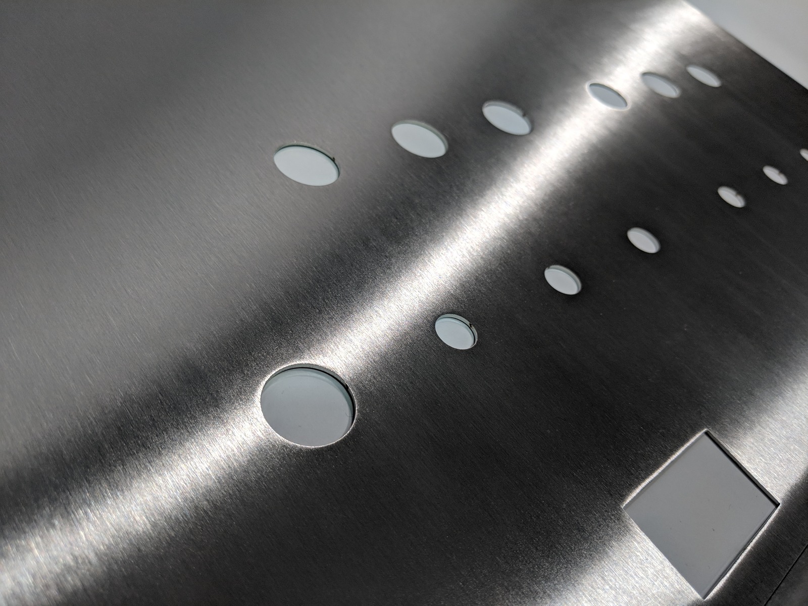

Grained Finish
Your part is de-burred, and then given a specific linear grain direction via brushing. It is the aesthetically superior option for bare finish for parts or enclosures that will be displayed.
