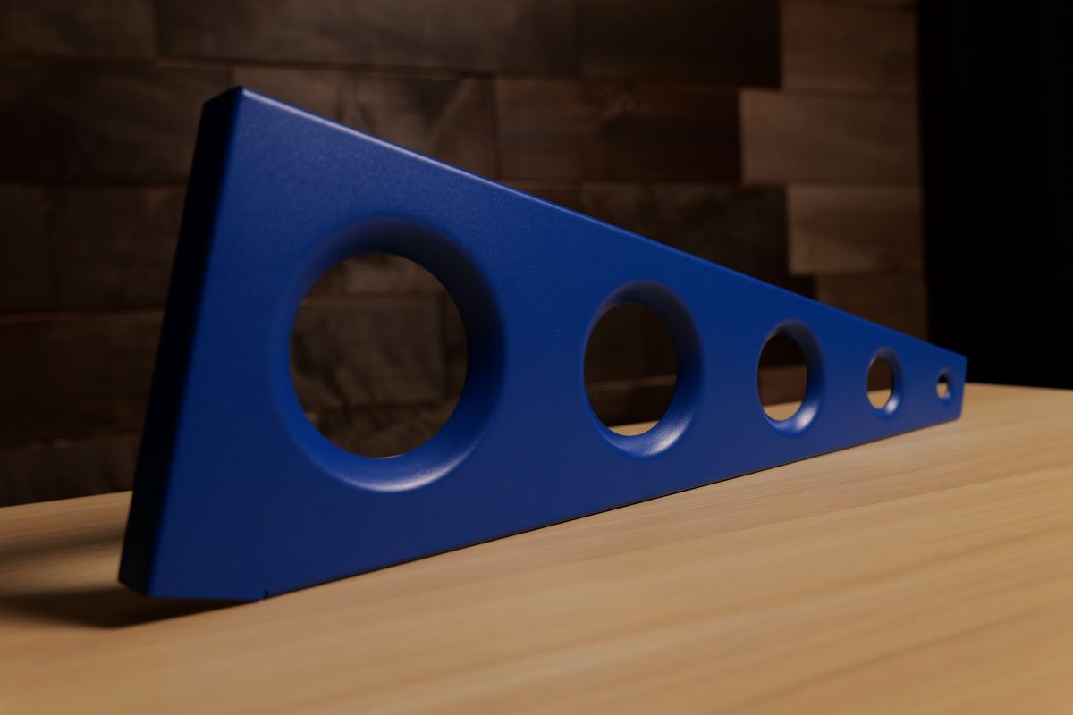

Dimple Forming
Dimple Forming involves pressing the edge of the hole between dimple dies to form a beveled/flared edge.

  • Strengthening: Dimples can stiffen thin parts, allowing for increased strength while reducing overall weight.
  • Weight Reduction: Material can be strategically removed by adding dimples, all while maintaining the part's strength.
  • Tread Plate: Small, protruding dimples create an effective anti-slip surface.
  • Cosmetics: Dimples can be used for aesthetic purposes.
