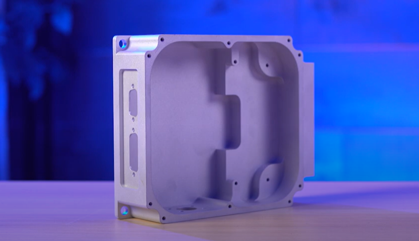

Machined enclosures are protective cases or housings made from solid material, typically metal and/or plastic, built using automated CNC machines.

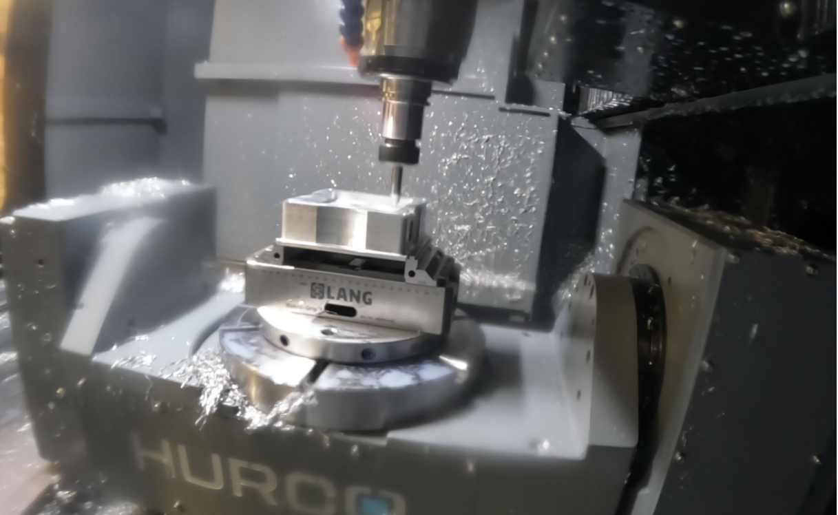

The process involves using CNC mills to cut, carve and shape raw material into customized enclosures with precision and intricate detailing. The computer-controlled process minimizes errors and executes complex designs with high accuracy.

The flexibility of the subtractive manufacturing process makes machined enclosures highly popular. This lets you place component mounting locations anywhere, offering incredible versatility and an unmatched range of possibilities.
For machined enclosures, standoffs can be any thread size, diameter or height, ensuring a perfect fit. In contrast, sheet metal standoffs are premade and may not fit as precisely.
You also get full control over the exterior. Machined enclosures generally look cleaner, as the exterior is made from a single piece rather than multiple flanges meeting at corners.

First off, remember that while CNC machines can handle complex shapes, simplifying your design can save time and be cost-effective.
If you have an enclosure with holes or slots on multiple faces, consider moving those details to the same face if possible. This will cut down on setup costs and save you some money.
Also, with machined enclosures, thick side walls are not hugely beneficial since they can make the case heavy. That said, they do make manufacturing easier because thicker walls are quicker to machine than thinner ones. With thinner features, it is necessary to slow down the cutting process and use additional work holding, which will lead to longer lead times. So, try to strike a balance.
