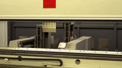

Protocase’s sheet-metal division includes a few different types of bending equipment, including LVD ToolCells. This multi-axis hydraulic press brake has automated tool changing technology, which minimizes setups, is fast and highly reliable.
LVD ToolCell bending machine at Protocase
In early February, a tool crash cracked the filler strip and sheared bolts inside the lower clamping bar of one of the LVD ToolCell machines. This crash rendered the machine unusable.

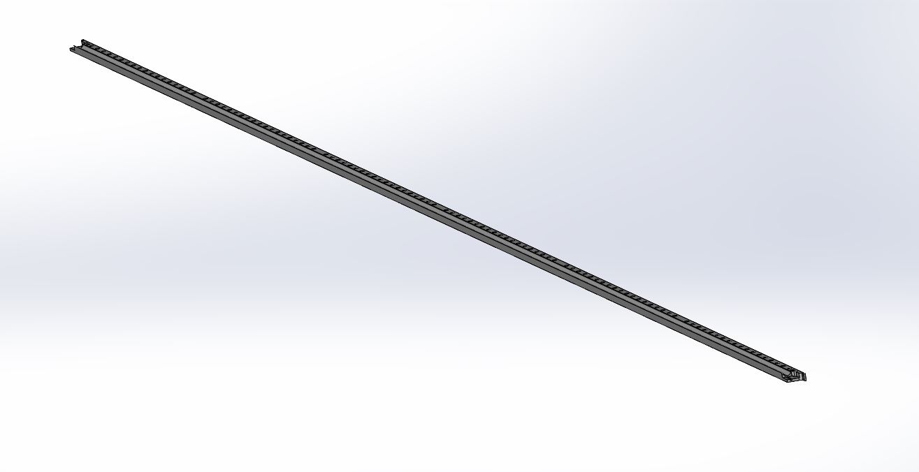

The tool crash had cracked the original filler strip nearly in half. The team was able to piece it together enough in order to measure it accurately for modelling purposes.
“The original part measured almost 10 feet long – that’s outside of manufacturing constraints,” explains Justin Lewis, mechanical engineer for Protocase CNC Machining. “It could not be manufactured in a single piece like the original was, so we had to split it into multiple pieces.”
With customer commitments on the line, and the LVD technician due to arrive the next day, Lewis and his team bumped this part to the top of the priority list.

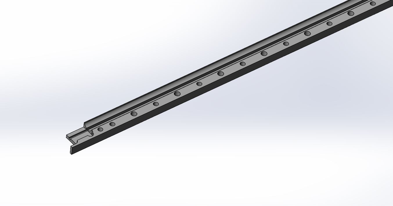

“It was a rather large part with a lot of features and dimensions, so measuring and modeling took a few hours. It then went directly to CNC programming, after a short time writing the programs, it went to the bandsaw, cut from our stocked material, and then straight to the milling machines,” says Lewis. “Our overnight shift had them ready for the next morning, just in time for the tech to arrive and install them without waiting.”
CAD model of replacement filler strip for LVD ToolCell by Protocase CNC Machining
The overnight shift had the new filler strip parts ready the next morning, taking the term “just-in-time manufacturing” to new levels. The technician from LVD Strippit’s North American distributor was scheduled to arrive onsite that same day to help recalibrate the lower clamping bar.
Close up of cad mode of LVD ToolCell filler strip by Protocase CNC Machining
“The tech was very impressed on how we were able within 48 hours have parts fabricated, installed and tested, which would have otherwise taken weeks,” explains Boutilier.

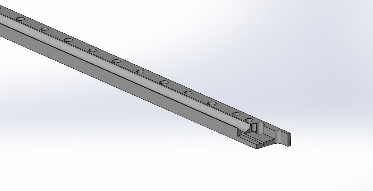

“I was concerned with changing the design from a single part to multiple smaller parts,” says Lewis. “I could not see a reason not to do so at the time. But sometimes, things are done for reasons we only see later. In this case, we assessed that the risk was worth the benefit and we decided to move forward.”
After thoroughly testing the new design, it worked just as well.
