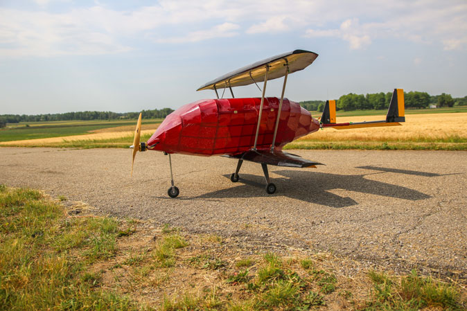

For the team to reach its goal of finishing first place, and aiming for a score two times higher than the previous winner’s score, they knew they had to take risks in their design. “For us, this translates into an ambitious design, as some of the design choices were previously unseen in our society and had no precedent, which meant our design had an equal chance of failing as succeeding,” explains Tejas. The design included a biplane (an aircraft with 2 sets of wings) to achieve the lift requirements with a drastically reduced wingspan. In previous competitions, the team had focused on aircraft with only one set of wings. “Designing this involved increased work from the aerodynamic and structures sub-teams, and accounting for factors that we could not foresee at times.”
The team’s lofty goals and design also dictated that the layout for the spherical cargo (soccer balls) be arranged in a manner that produced the biggest aircraft fuselage that the society has ever seen. The aircraft’s main body would span 27” in width, compared to 9” in width in the previous year’s design. On paper, a design this big seemed to prove it could work, but would it fare the same in a real-life flight test?

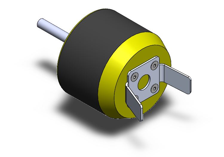

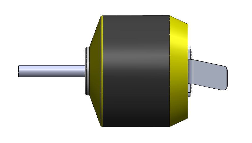

The team took advantage of Protocase’s student sponsorship program by designing two unique parts. The first was an aluminum attachment piece that secured the electric motor to the rest of the fuselage through riveting.

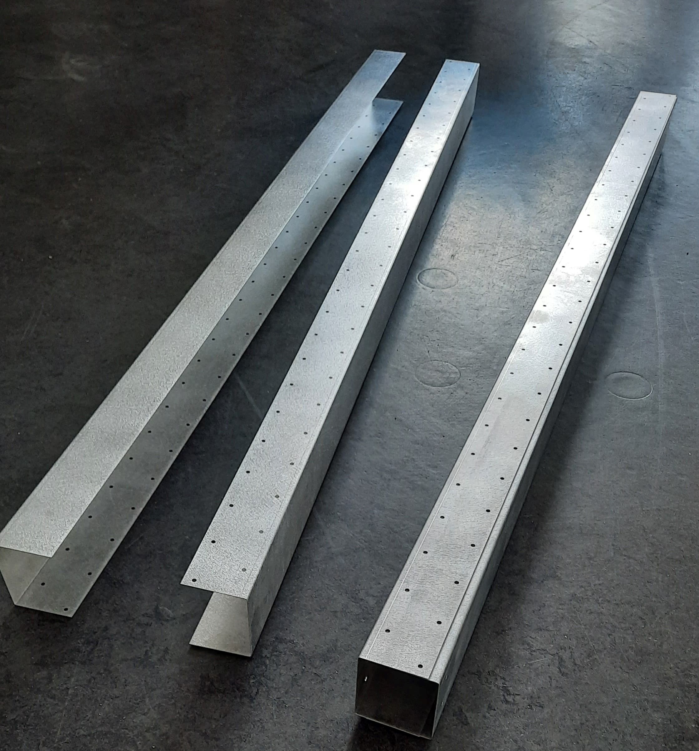

The second component sourced through Protocase’s ultra-fast custom manufacturing was a built-up beam made of aluminum sheet metal. “When assembled, these beams produced the main structural component of our top wing in the biplane arrangement, which also provided support against lift as well as torsional forces,” says Tejas.

In the end, Concordia SAE AeroDesign could not attend the SAE AeroDesign competition due to COVID-19 travel restrictions. However, the team put its design through its paces by competing remotely in Saint-Remi, Quebec. The Regular class team encountered technical difficulties during the first flight round, however, that did not prevent the team from fixing them and flying a second round. The Advanced class team flew admirably from the start, and did not look back.
