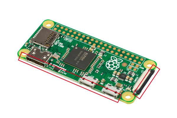

Of all of the custom enclosure styles we can manufacture at Protocase, the U-Shape is the one of the simplest to both design and build. Also known as a “clamshell” design, U-Shape enclosures are an excellent choice for printed circuit boards when a component protrudes from adjacent sides, such as a Raspberry Pi board displayed below. But for certain scenarios, L-Shape enclosures are your best bet. This blog post will show you when to choose L-Shape enclosures over U-Shape enclosures.

A U-Shape enclosure will work for PCBs with components that protrude from neighboring (adjacent sides), because of the make-up of a U-Shape enclosure.
However, if your enclosure needs to accommodate a component that protrudes from opposite sides, such as a PCB with opposing connectors, the U-shape style is not going to work.
Because the connectors protrude through each side of the enclosure, you will not be able to insert the PCB in a U-Shape enclosure unless you stretch at least one enclosure side, in which case the enclosure will most likely be out of position when you bend it back.

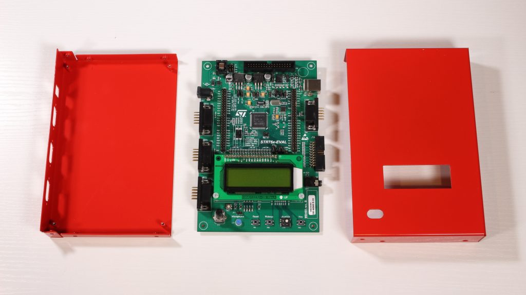

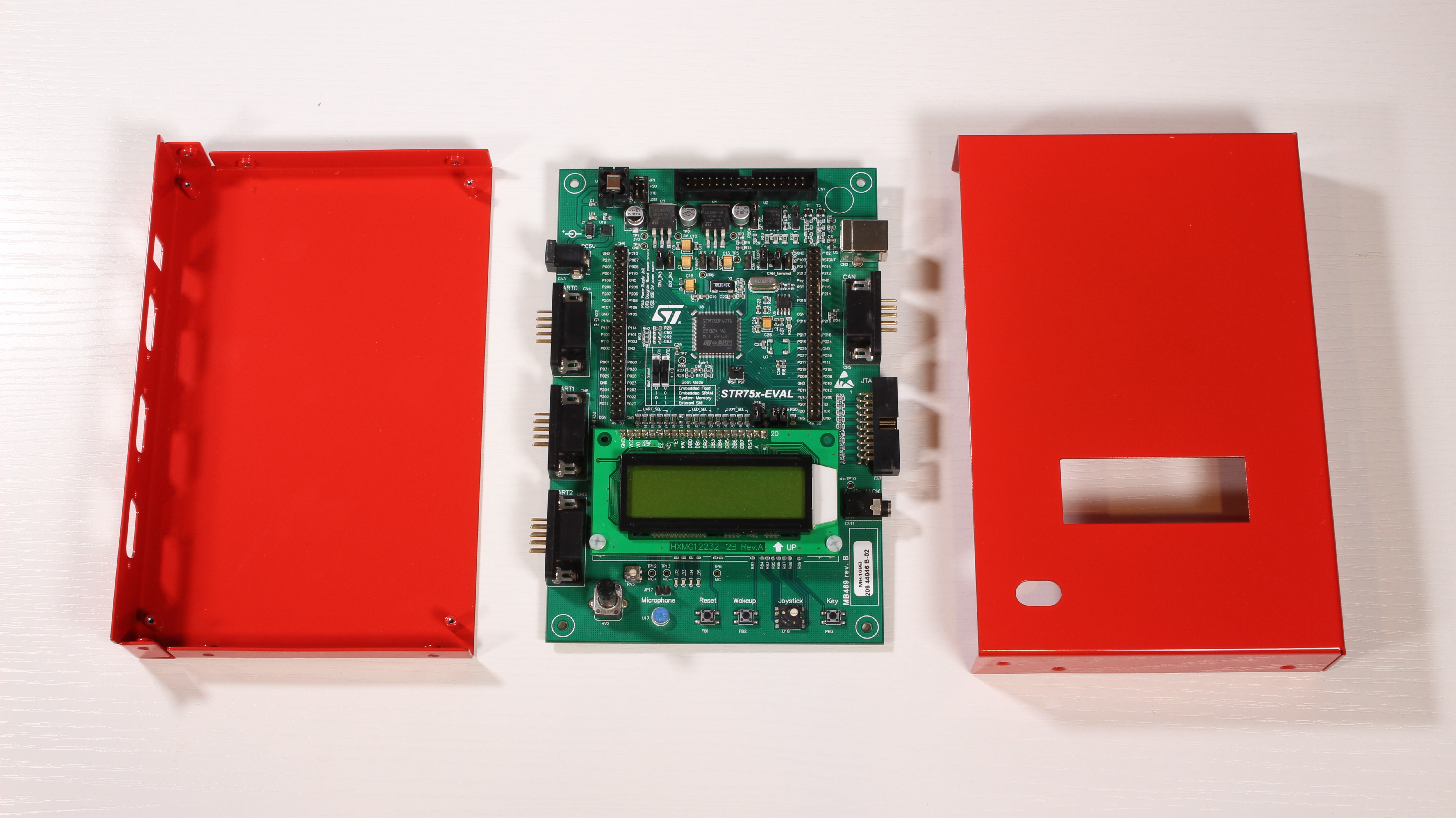

Here’s a bird’s-eye view of an L-Shape enclosure in two pieces, along with a PCB with protruding connectors.
Step 2
Slide the PCB into the bottom piece.
Step 3

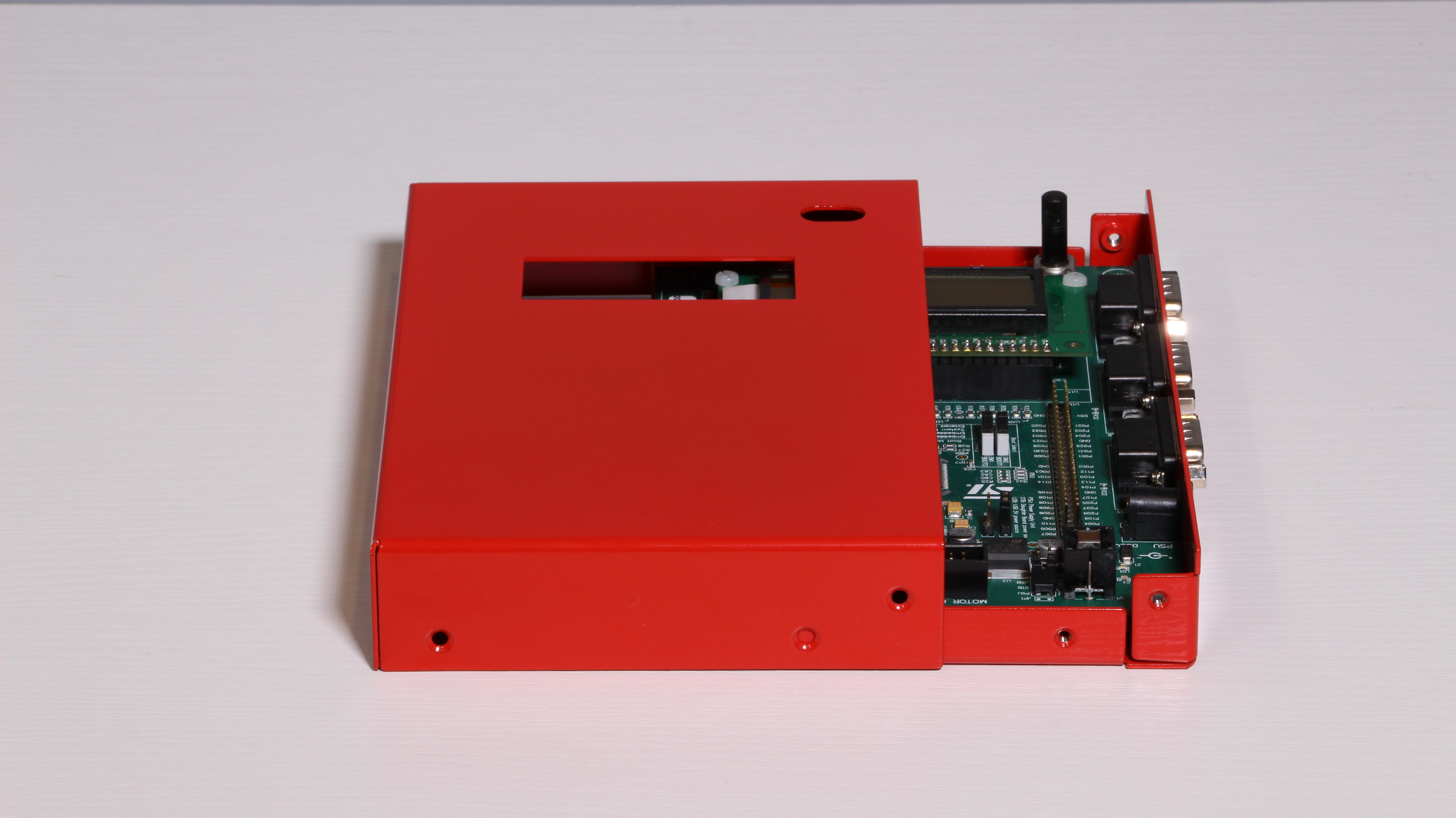

Slide the top piece over the bottom piece with the PCB in place.
Step 4
Use your desired fasteners to put your enclosure together.
One thing to note: You may notice the connector protruding out of this specific L-Shape enclosure, and wonder why the cutout is slotted to fit over the knob. We designed this particular enclosure in such a way so that the cover would be able to slide down and over top of the connector.
A U-Shape enclosure’s cover would be able to just drop directly over the connector, which would negate the need for a slotted hole – but as discussed, a U-Shape wouldn’t work well for this particular PCB because it has connectors protruding from opposing sides.
