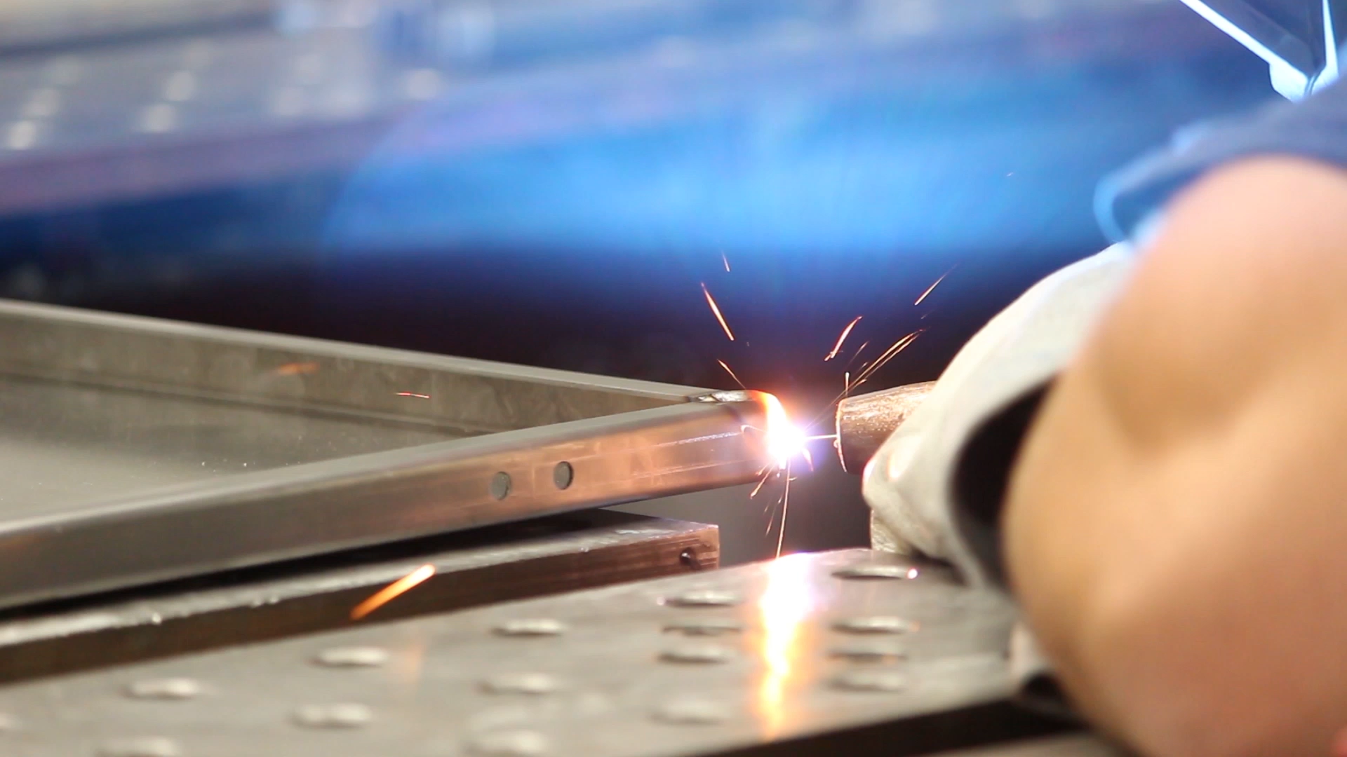

Cold Metal Transfer Welding close up
How Does CMT Work?
CMT welding has an exceptionally stable arc. The pulsed arc is made up of a base current phase with a low power and a pulsing current phase with high power without short circuits. This leads to almost no spatter being produced. (Spatter are droplets of molten material that are generated at or near the welding arc.).
In the pulsing current phase, the welding droplets are detached in a targeted manner via a precisely dosed current pulse. Because of this process, the arc only introduces heat for a very brief period during the arc-burning phase.
The arc length is detected and adjusted mechanically. The arc remains stable, no matter what the surface of the workpiece is like or how fast the user welds. This means CMT can be used everywhere and in every position.
The CMT process physically resembles MIG welding. However, the big difference is in the wire feed. Rather than continuously moving forward into the weld pool, with CMT, the wire is retracted the instant current flows. The weld wire and a shielding gas are fed through a welding torch, the electricity arcs between the weld wire and the welding surface – this causes the tip of the weld wire to liquefy and to be applied to the welding surface. CMT uses automatic activation and deactivation of the heating arc to systematically heat and cool the weld wire while bringing the wire into and out of contact with the weld pool many times per second. Because it uses a pulsing action instead of a continuous stream of power, CMT welding generates only one-tenth of the heat that MIG welding does. This reduction in heat is CMT’s greatest benefit and is why it’s called “Cold” metal transfer.
