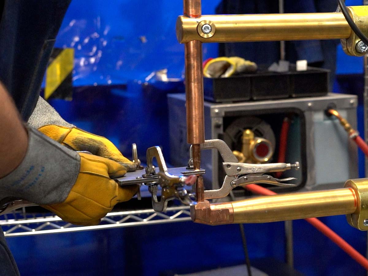

Spot Welding
  • Fast and efficient method of permanently joining two pieces of sheet metal in one or more spots.
  • It can be used in place of using fasteners, as well as joining two or more assemblies together.
  • Unlike threaded fasteners, spot welding results in little trace of the joint.
Spot Welding
Materials
  • Stainless Steel
  • Cold Rolled Steel
  • Galvanneal
  • Aluminum
Spot welding strength varies per material, but of the three listed above, stainless steel produces the strongest spot weld.

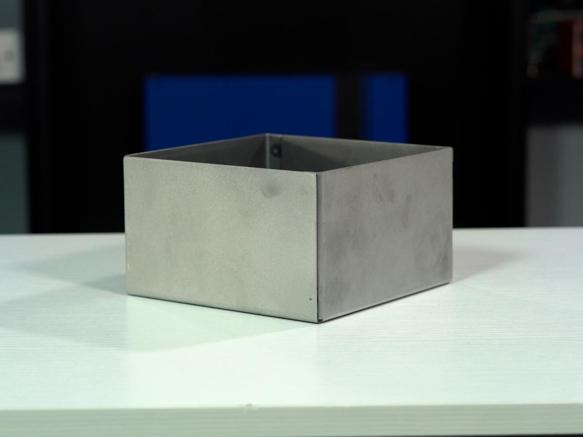

NOTE: In order to spot weld galvanneal, the material must be grinded down first.
Finishes
You may opt to grind the spot weld down in order to achieve the smoothest surface finish.
In addition, spot-welded parts may be finished in any of the following ways:
  • Powder Coat
  • Grained Finish
  • Passivation
  • Digital Print
  • Silkscreen
  • Laser Marking
