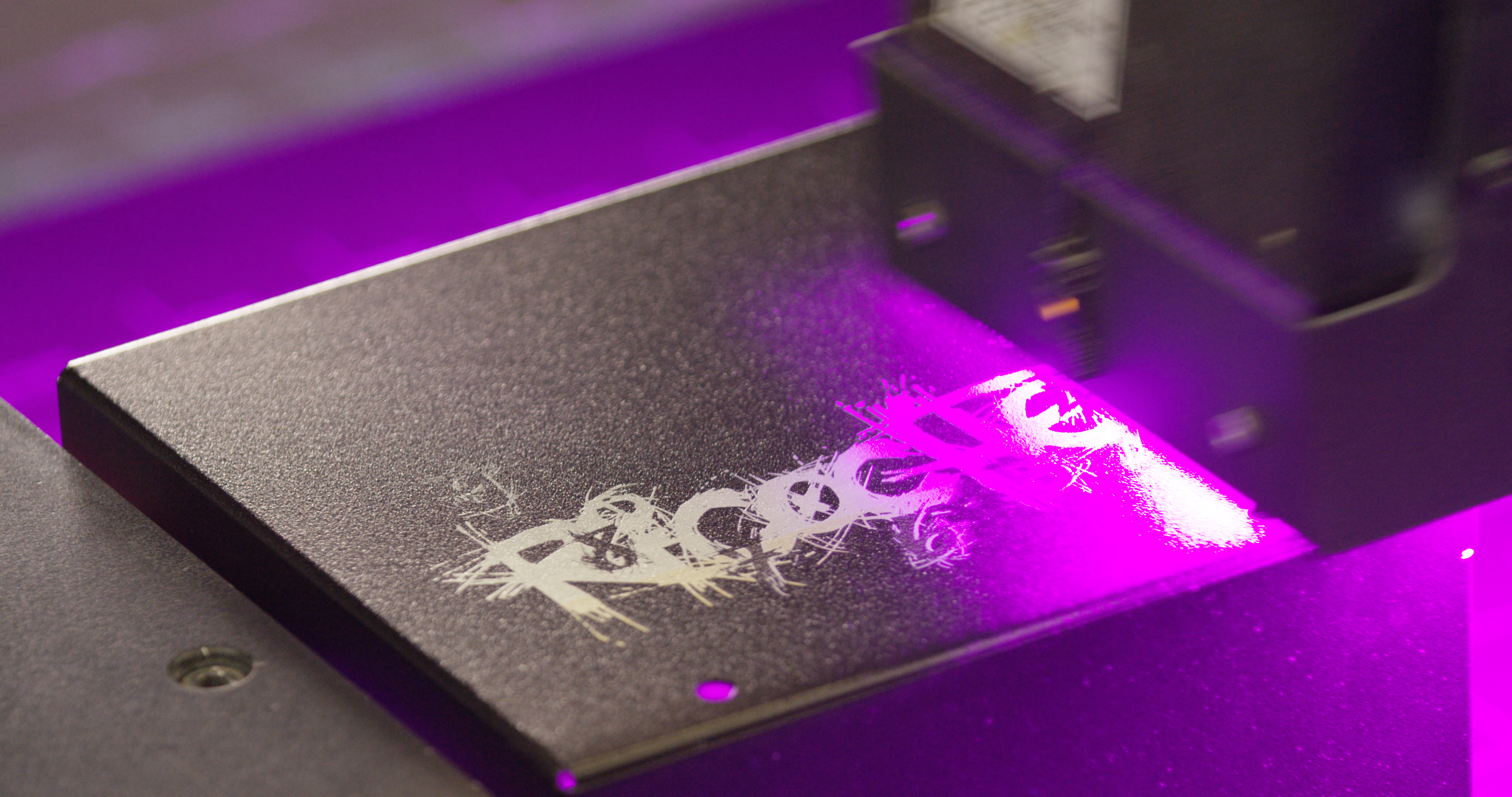

Digital printing is done by blending densities of cyan, magenta, yellow and black ink using industrial printers. As the UV printhead makes passes on the surface of the metal, the ink is then layered and instantly cured. This creates a linear texture that we call banding.
The UV printhead makes passes on the surface of the metal
UV printhead making a pass on the surface of metal during the digital print process

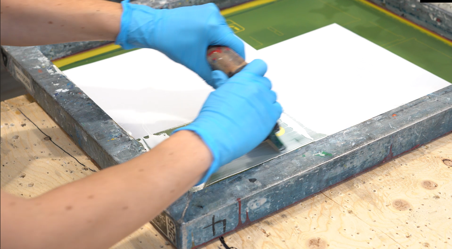

Silkscreen, on the other hand, involves burning graphics into a porous screen that is pretreated with photo emulsion. After burning in the graphics, we pressure wash the screen, which leaves an opening where the graphics were burned in. From there, the screen is laid onto the metal when the epoxy silkscreen ink is passed over. The ink goes through the screen and is applied directly to the metal surface.
With silkscreen, we currently stock 16 different colors. You can find them on our website here. If your graphics have minimal amounts of color and are simple in nature, silkscreen is your best bet.
Remember, each silkscreen color must be applied separately using a unique screen. So, the more colors you have in your graphics, the more screens that need to be created. This will increase your lead time and price. Therefore, if your graphics have several different colors (or colors beyond what our 16 stocked silkscreen colors), digital print will be your optimal choice.
Silkscreen process
One of the procedures during the silkscreening process

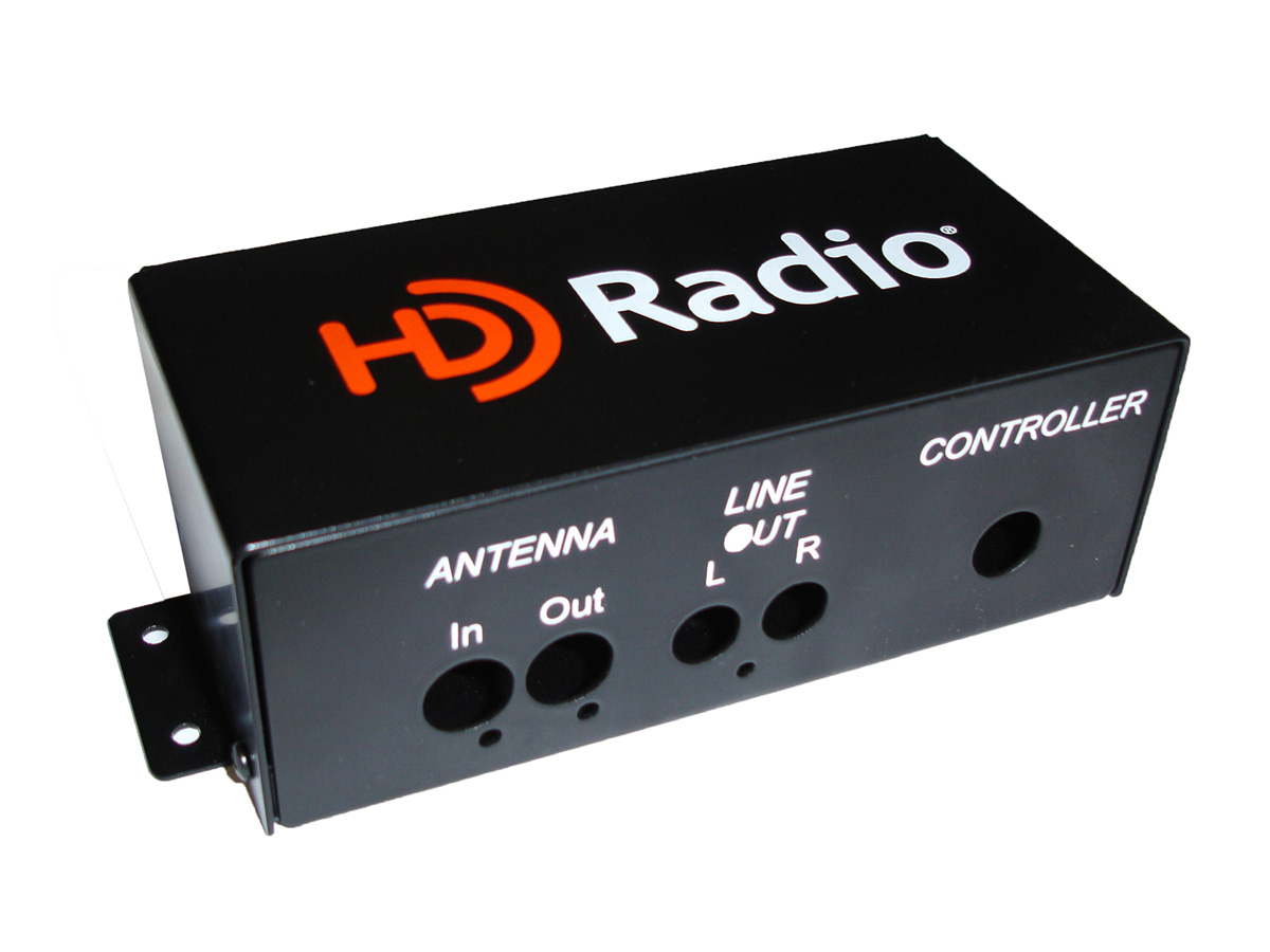

Silkscreen ink is self-leveling. So, you can only feel a slight raised surface which produces a smooth finish that is virtually indistinguishable by touch. With digital print, meanwhile, you can feel the slightly raised texture of the graphics.
A sample of silkscreening
An HD Radio enclosure which used silkscreening
In the end, this comes down to your personal preference. Some engineers and designers prefer the feel of silkscreen, while others feel that digital print’s flexibility far outweighs its texture.
