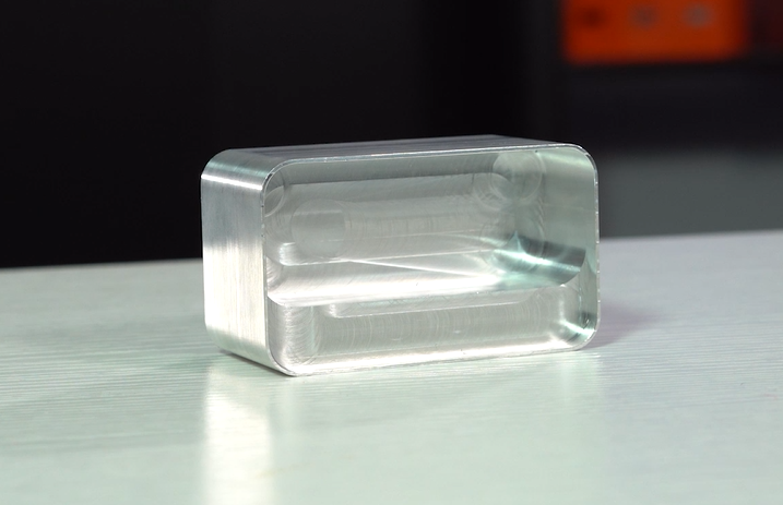

Pockets
Deeper pockets can be challenging to machine due to limited tool reach and potential for tool deflection. To overcome these issues, limit the depth of pockets, or consider splitting the depth into multiple steps if the design allows.
A machined part with pockets
