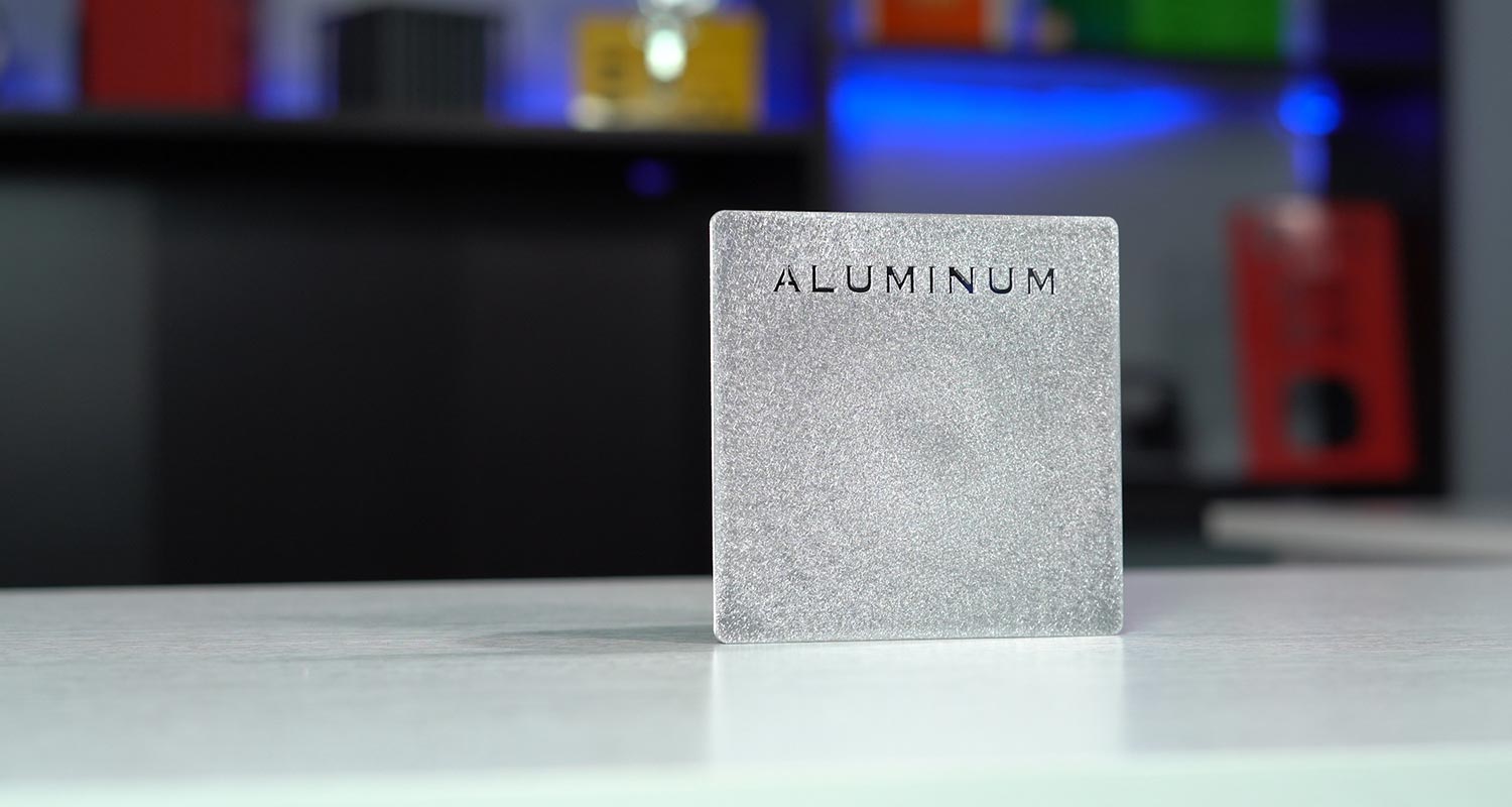

First off, choosing the right material is the first and most impactful step in reducing weight.
When choosing between aluminum, stainless steel, galvanneal and cold rolled steel for weight reduction in sheet metal designs, aluminum often stands out as the best option. Aluminum is significantly lighter than the other materials while still offering excellent strength-to-weight ratio and corrosion resistance.
However, the suitability of aluminum also depends on specific operational requirements, including environmental exposure and mechanical stress. If higher strength or enhanced durability is required alongside weight reduction, stainless steel or galvanneal may be viable alternatives, albeit they will be slightly heavier.
Secondly, optimizing your design before manufacturing is going to be important. Be sure to design your parts and enclosures with minimum material usage. This can include strategies such as redistributing material where strength is most needed. Here are a few strategies when you’re in the design phase:
  • Incorporate cutouts in low-stress areas to eliminate unnecessary material.
  • Leverage SolidWorks’ built-in sheet metal tools to accurately design and modify parts and enclosures. Apply features like flanges, hems and jogs to add strength without significantly increasing weight.
  • Traditional fasteners like screws and bolts add unnecessary weight and can require additional material for reinforcement. Instead, techniques such as welding or adding rivets can be incorporated to create secure joints with minimal added mass.
An aluminum part
Aluminum is significantly lighter than the other materials we stock

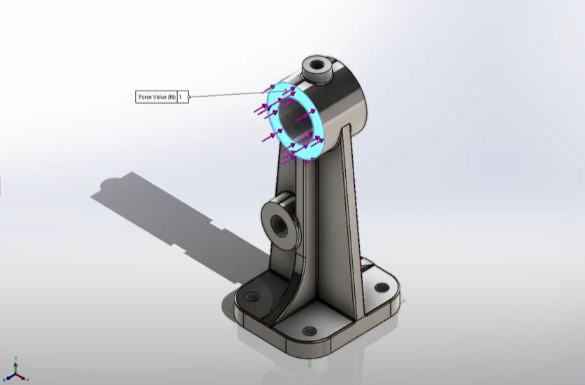

Secondly, think about utilizing hollowing when designing CNC machined enclosures. Hollowing out non-structural areas inside your enclosure can be one of the most effective ways to reduce the weight of CNC machined enclosures. Creating pockets and other features in your design can remove wasted material without compromising the structural integrity of the enclosure.
Lastly, think about adding support structures inside your design. One common method for increasing the durability of an enclosure is to increase the “bulk” or mass of it. Instead of increasing bulk for strength, consider adding support structures to key load-bearing areas. These features provide rigidity without unnecessary weight.
Perform simulations inside your CAD program to identify regions of high stress and strategically place reinforcements only where needed, avoiding unnecessary support that would add weight.
Design in a CAD software
