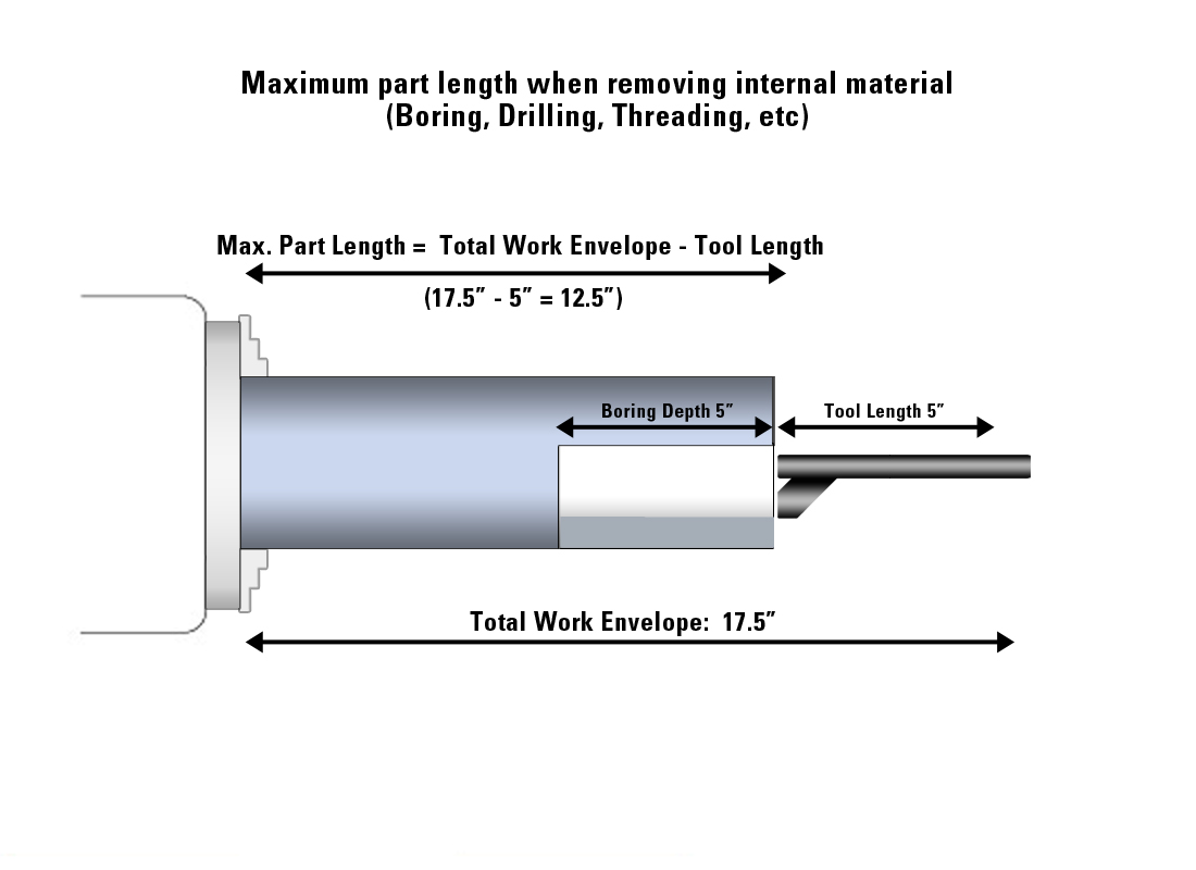

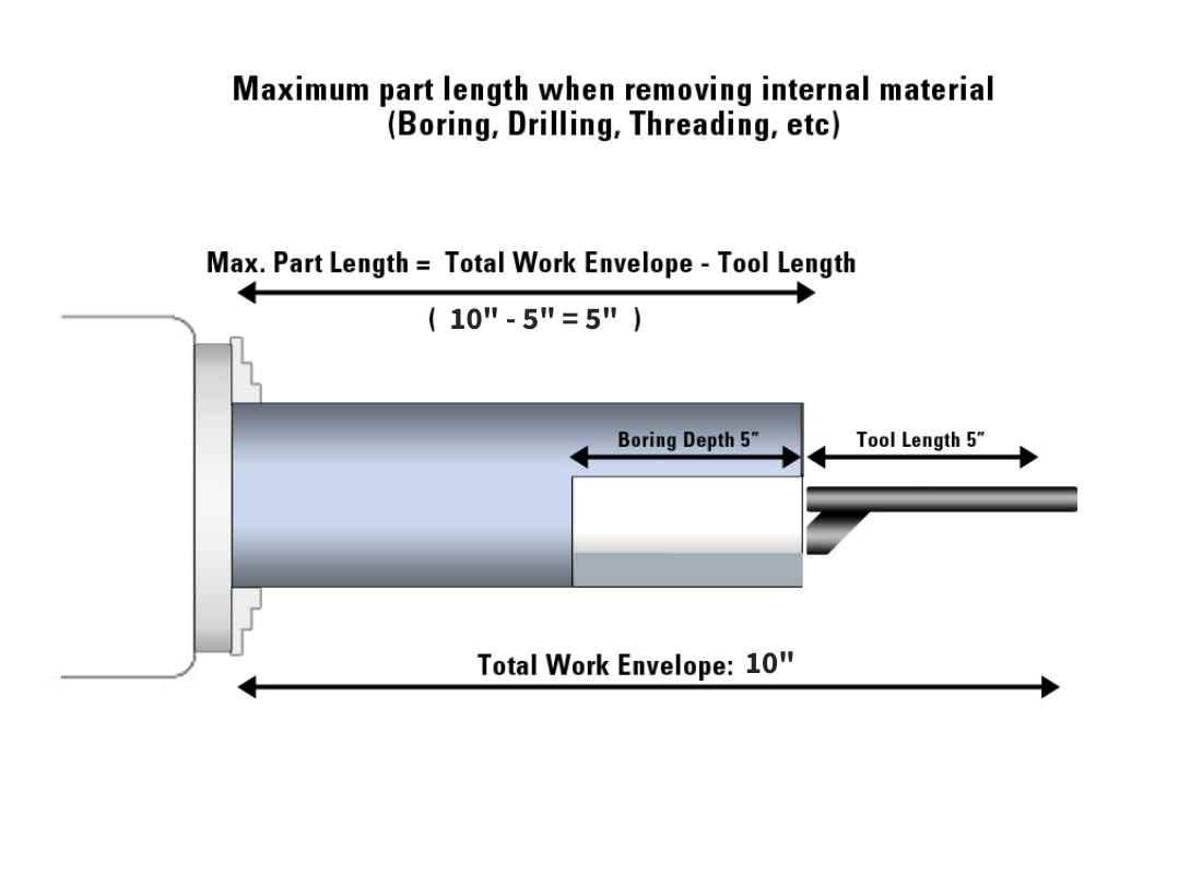

*Internal features, such as bores, will reduce the max total length of part achievable. Simply subtract the maximum bore depth on your part from 16” to calculate your max part length. (Example, if a part has a 4” deep bore, its max length is 12”).
