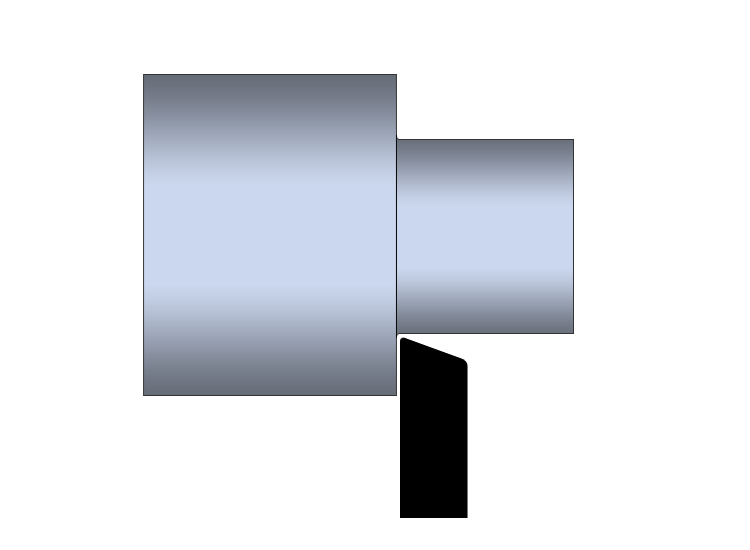

Protocase utilizes an 8" diameter chuck with a 2" spindle bore that spins at 4,800 RPM, which is designed to hold round stock of almost any material.
Because the lathe is its own work holding, it needs enough geometry to support itself while rotating. It also needs to support the cutting forces required to cut it into shape, ergo limitations on the ratio of diameter to length are important. For example, a 1/8" diameter rod cannot be machined 12" from the chuck as the part would bend. Generally speaking, the stick out cannot exceed five times the diameter of the part. However, this rule is often broken when dealing with certain geometries.

Finishing and Turning Toolmarks:
The surface finish of CNC turned parts will have visible toolmarks, due to the spinning motion produced by the CNC lathe's cutter. This is considered a turned finish.
