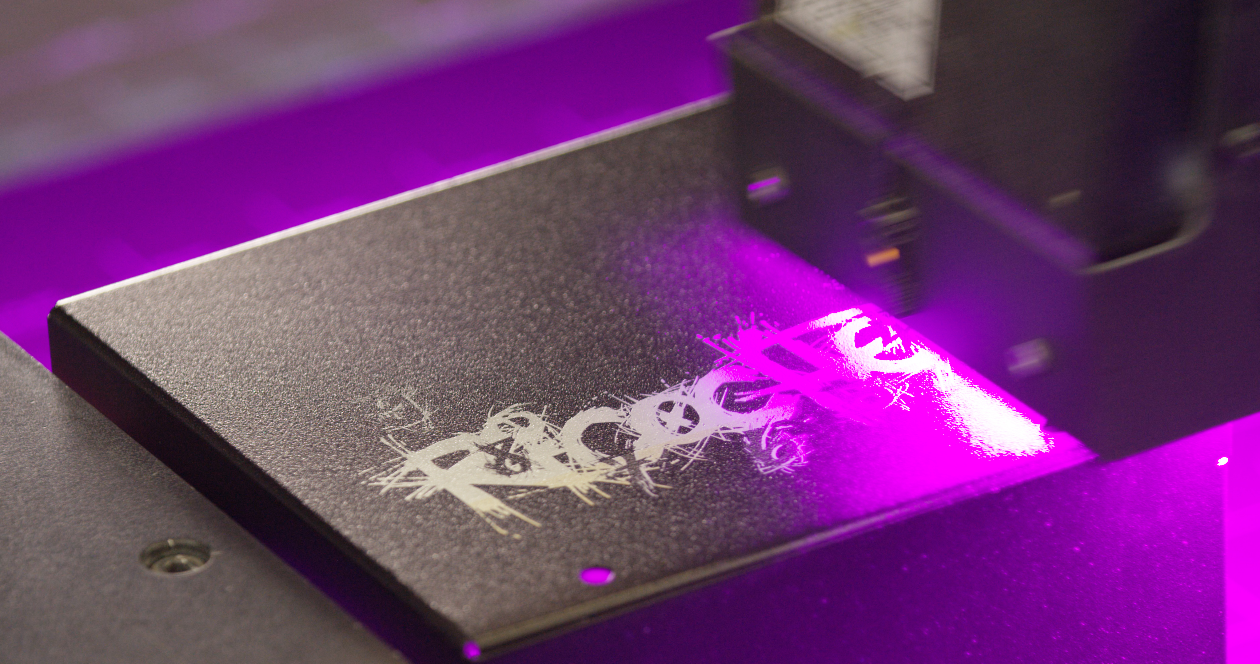

Custom enclosure with black sandtex powdercoat is digitally printed
When using a Sandtex powdercoat, it is recommended that you use digital print to apply any graphics to your part or enclosure. This is because the ink jets are pointed down and fill the low-end points of the texture, causing the digital print to stick well to the part.

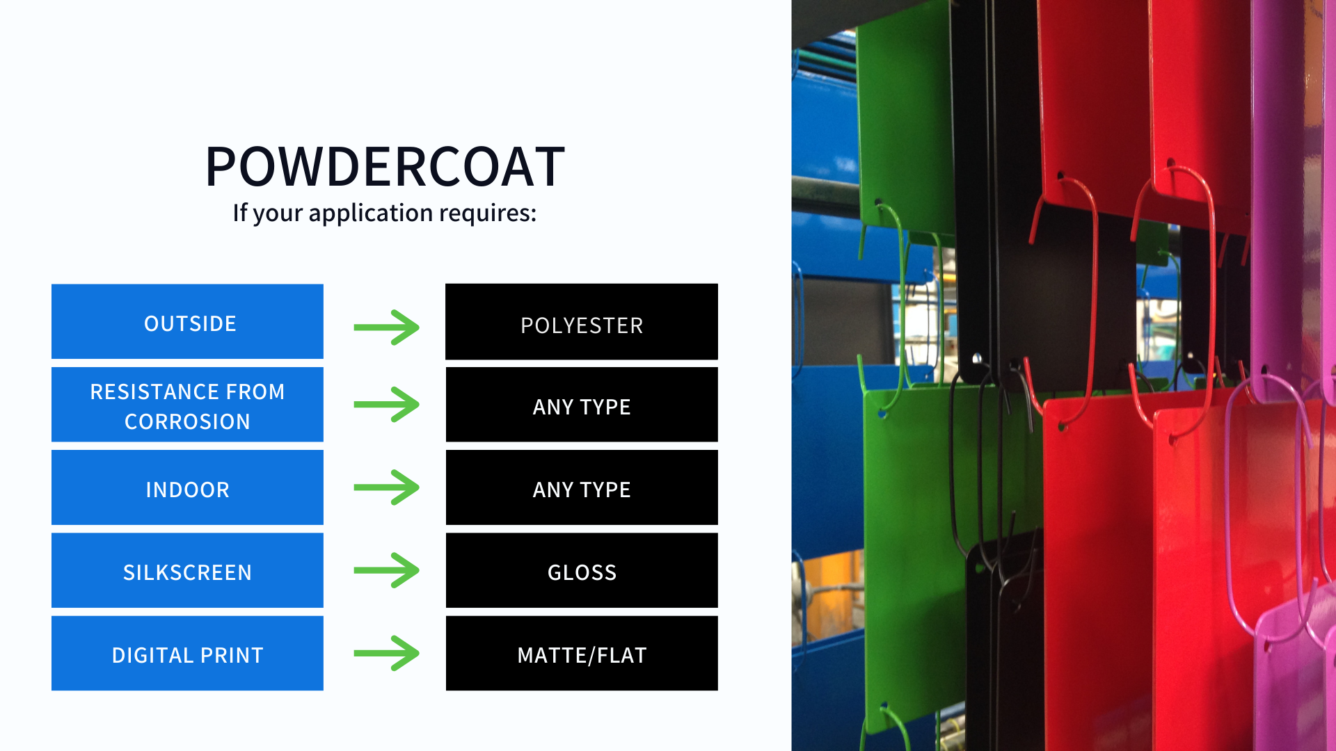

The powdercoat you choose should match your requirements and application.
Use this quick-reference guide to make sure you’re choosing the correct powdercoat for your specific use case:
Powdercoat use case guide
