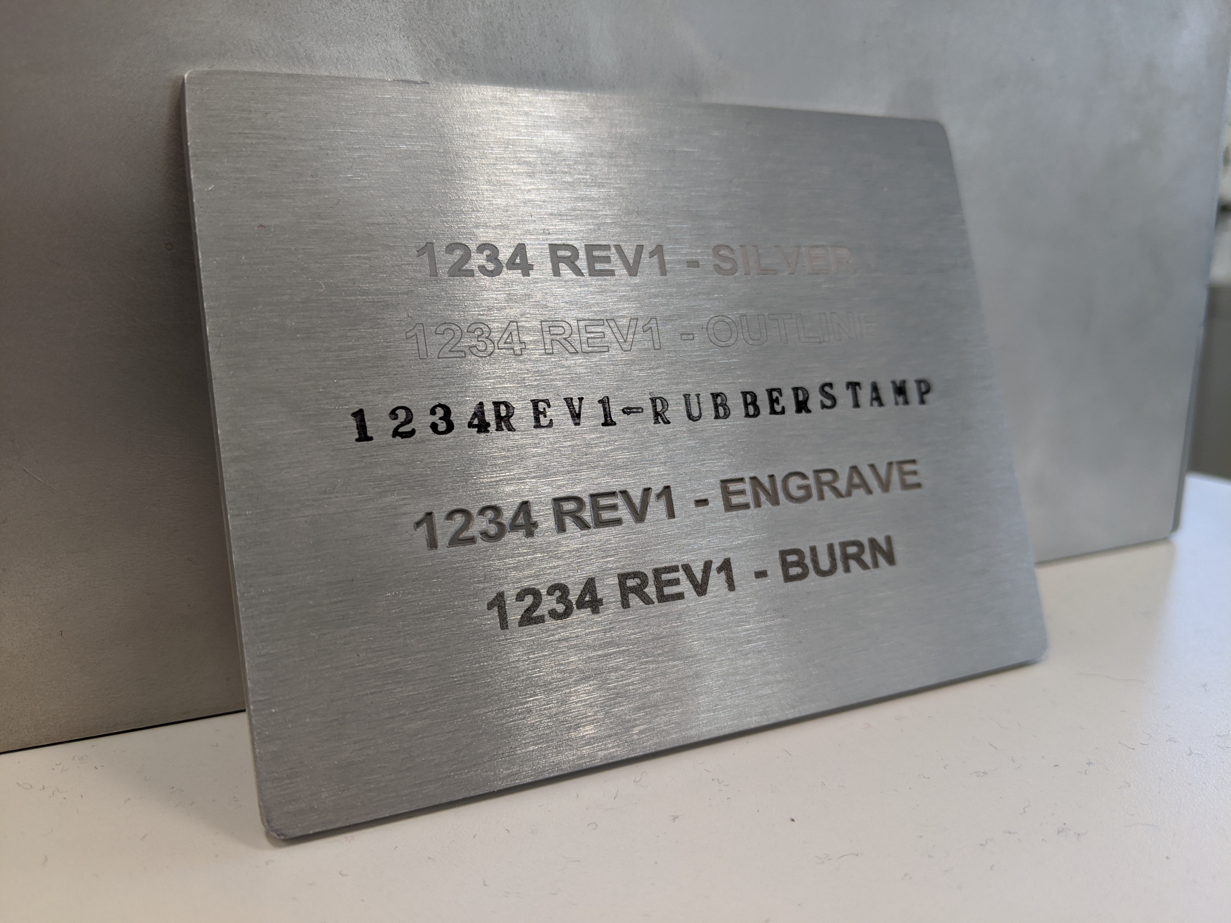

Part marking on a sheet metal part.
Examples of some of the different types of part marking

Laser Marking
Laser marking is an ultra-precise, efficient means of permanent marking that offers an enormous amount of versatility. We offer several different kinds of laser marking: engrave burn, silver, outline, ablate and anneal.
Renowned for its precision, laser marking can produce highly detailed markings. These include serial numbers, intricate logos, as well as barcodes and QR codes.
