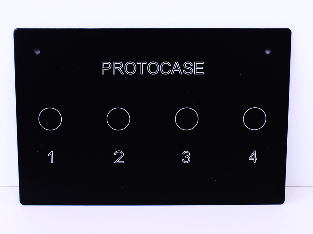

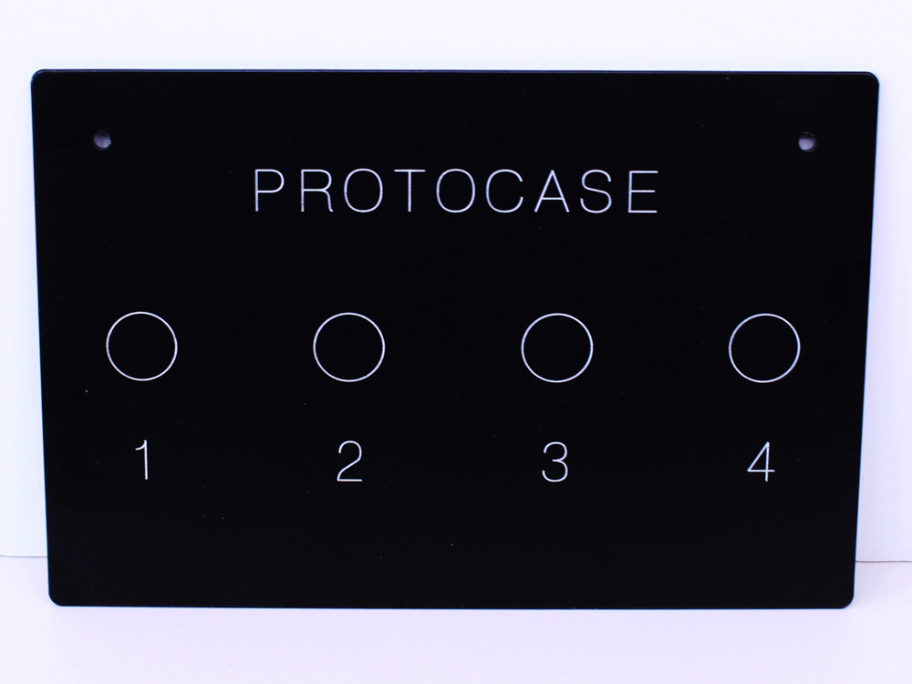

Protocase offers machined engraving on machined parts in 2-3 days, with no minimum order. Also known as machined etching, this process offers permanent marking on your enclosure, panel or part, which is ideal for labeling, branding or schematics.
Machined engraving can be done on aluminum, stainless steel and cold rolled steel.
Constraints:
The maximum size of machined parts we are able to engrave in a single setup is 26" x 16" (660.40mm x 406.40mm).
Engraving Depth:
The depth of Protocase's machined engraving is standard, set at 0.010" (0.25mm).
Our standard machined engraving depth can vary depending on the material used, as well as any secondary finish applied post engraving. For example, stainless steel and cold-rolled steel's stiffness will produce a shallower depth compared to aluminum, which is a more lightweight material.
Font Capabilities:
Maximum font size is only limited to the size constraints of our milling machine (see above). For ideal legibility, we recommend using a font with a size no lower than 10pt.
