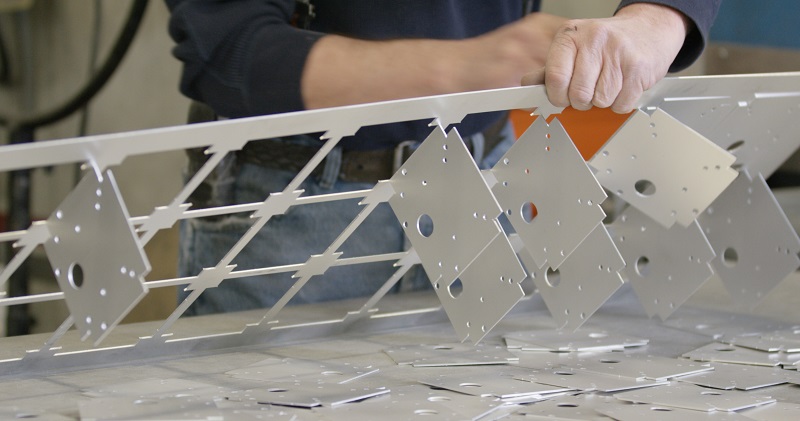

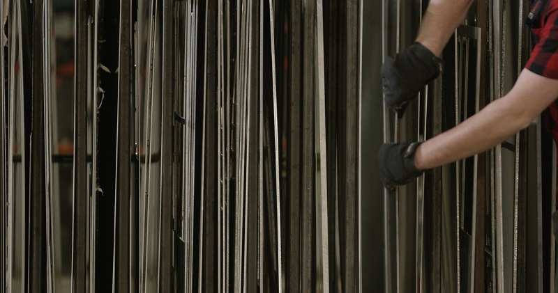

#1: Stick Within Stocked Materials
The first – and most important – tip for avoiding unnecessary cost overruns is to stick within our stocked material, thicknesses and components. Our website thoroughly lists all of the materials, fasteners, components and hardware that we stock as inventory. If you use what we keep in stock, you can avoid increased costs AND extended lead times.

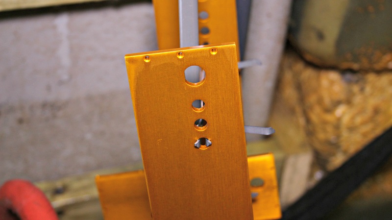

#2: Stay In House
Parts being anodized by a third-party supplier
Protocase is virtually a one-stop shop for fully-finished enclosures, panels and parts, so we do all of our powdercoating, brushing, chem film, graphics and more in-house. However, there are a few finishes that are completed by a third-party, including anodizing and tin plating. If you are looking to cut costs in your design, you should stay within our in-house finishes, and only choose anodizing or tin plating if it’s an absolute requirement for your project.

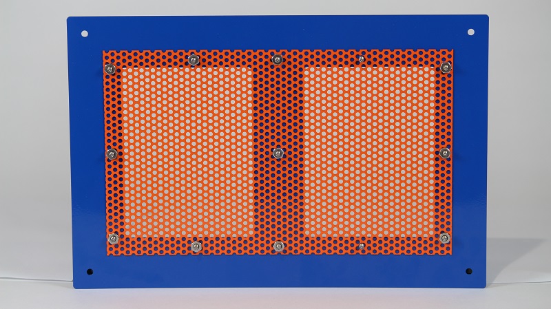

#4: Use Cutouts Judiciously
The beauty of Protocase’s custom manufacturing is that we can create your design exactly as you intended it. If you have designed an enclosure that has hundreds of cutouts for ventilation purposes, our lasers or CNC routers will need to cut each hole individually. If you are budget conscious, we recommend using perforated sheet metal or changing your holes to slots. Not only will this keep your enclosure cost-effective, it will also prevent your enclosure from warping.
Backside of Panel with Perforated Aluminum Attached via Fasteners

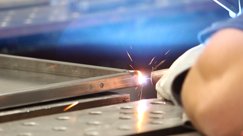

#6: Fasteners vs. Welding
Parts being welded
Parts being welded
When it comes to attaching the parts of your enclosure assembly together, you can either choose to have parts welded together, or you can use fasteners. If you are budget-conscious, we recommend using fasteners in your enclosure rather than welding, unless your project has a strict requirement for welding. And, if your design requires welding, you can opt for a mix between fasteners and spot welding, rather than full seam welding, for some cost savings.
