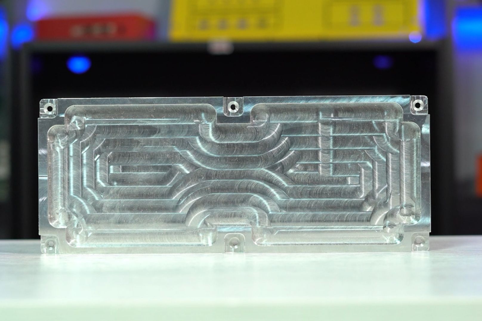

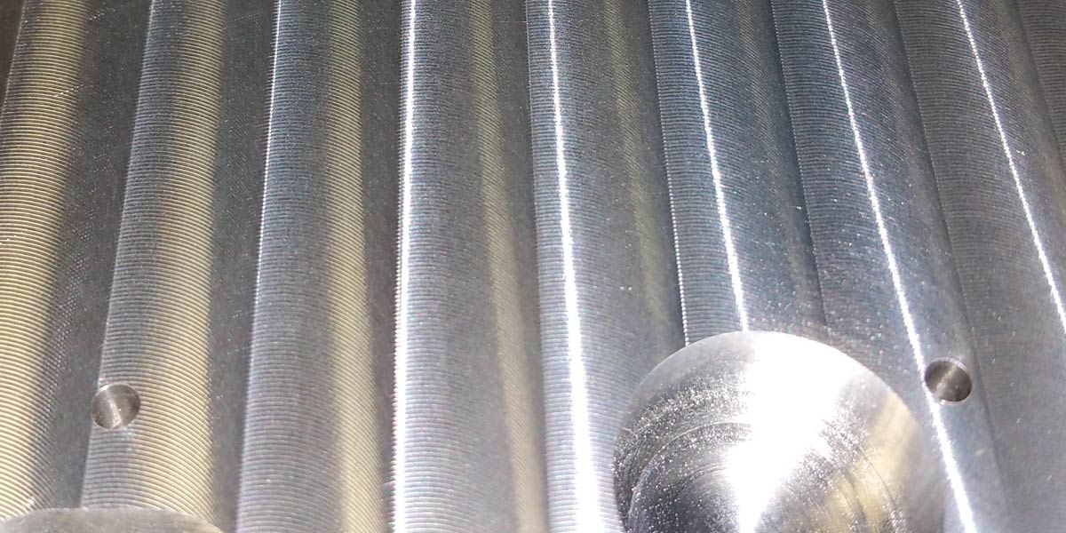

CNC Machining creates a unique finish with visible toolmarks, due to the spinning motion produced by our CNC milling machines' cutters. Minor surface scratches, blemishes and swirl marks are to be expected for a CNC machined part with no additional finishing applied.
No Finish:
The as-is appearance after a part is machined. There will be visible toolmarks in swirl patterns, due to the spinning motion produced by the CNC mill's cutter.
Things to Consider:
- • Appearance is not decorative in any way. No Finish is best for parts that will not be on display.
- • Most cost-effective option where a uniform finish is not required.

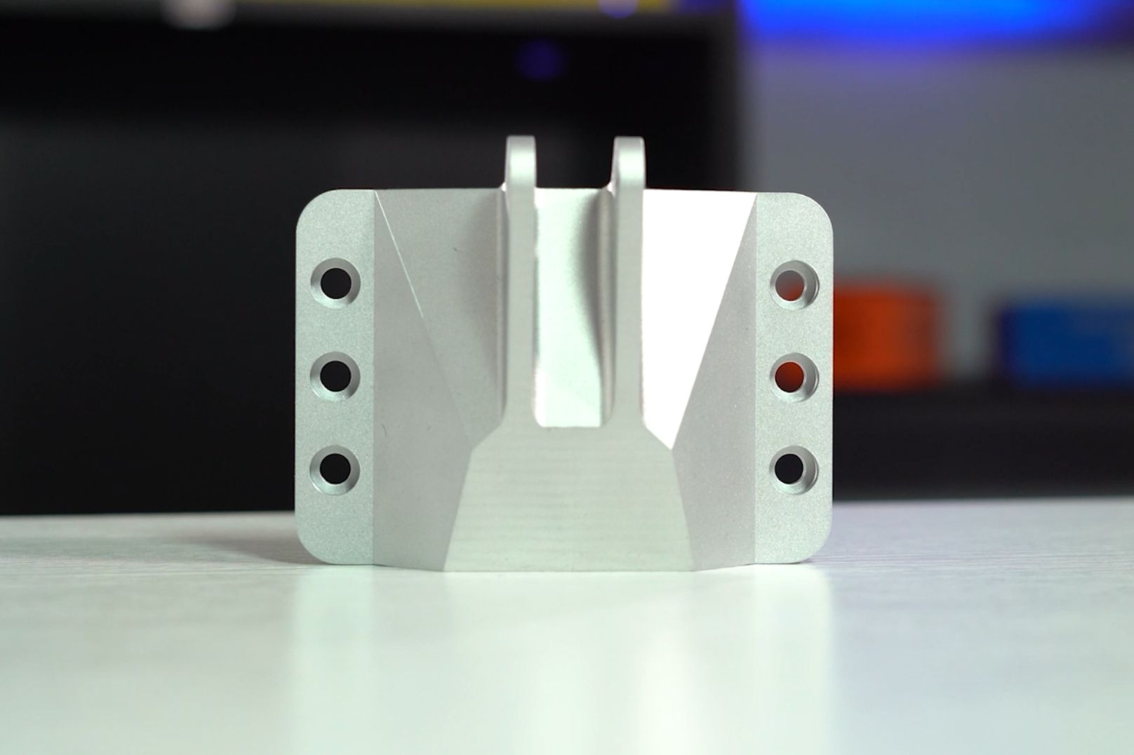

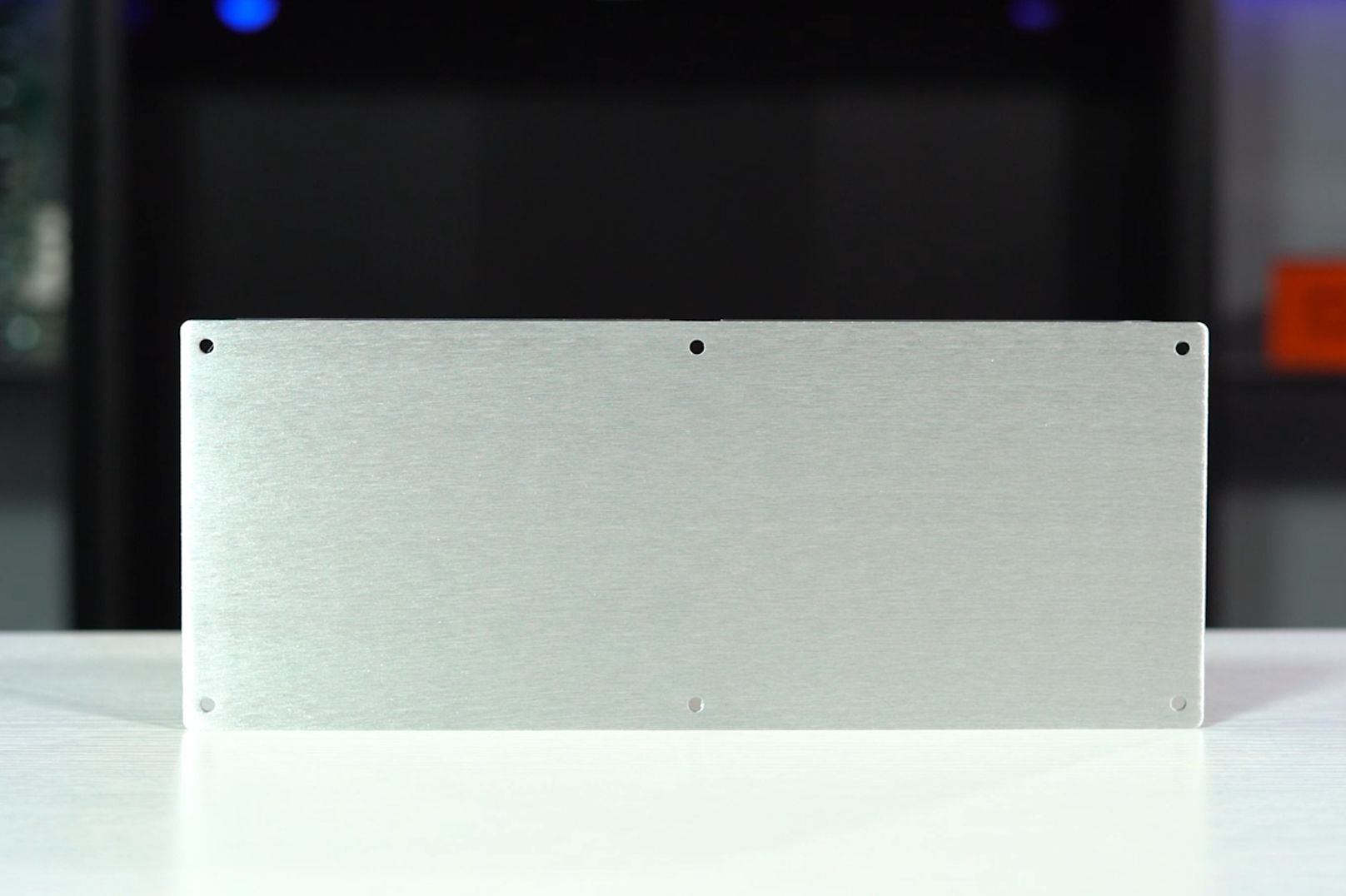

Grained Finish:
Once a part is CNC milled, the surface is finished using a brush/sander in order to achieve a specific grain.
Things to Consider:
- • Ideal for flat parts
- • Due to geometry, grained finish can only be applied to the outside surfaces of CNC machined cases and parts are not on the inside pockets.
- • If choosing grained finish for machined parts with pockets, only the outermost surfaces will be grained finish. The pockets will remain unfinished.
- • Parts with protruding features or bosses limit the ability to apply grained finish.
- • Can be digitally printed, silkscreened, laser marked or engraved (as long as it’s a flat surface)
Learn more about Grained Finish.

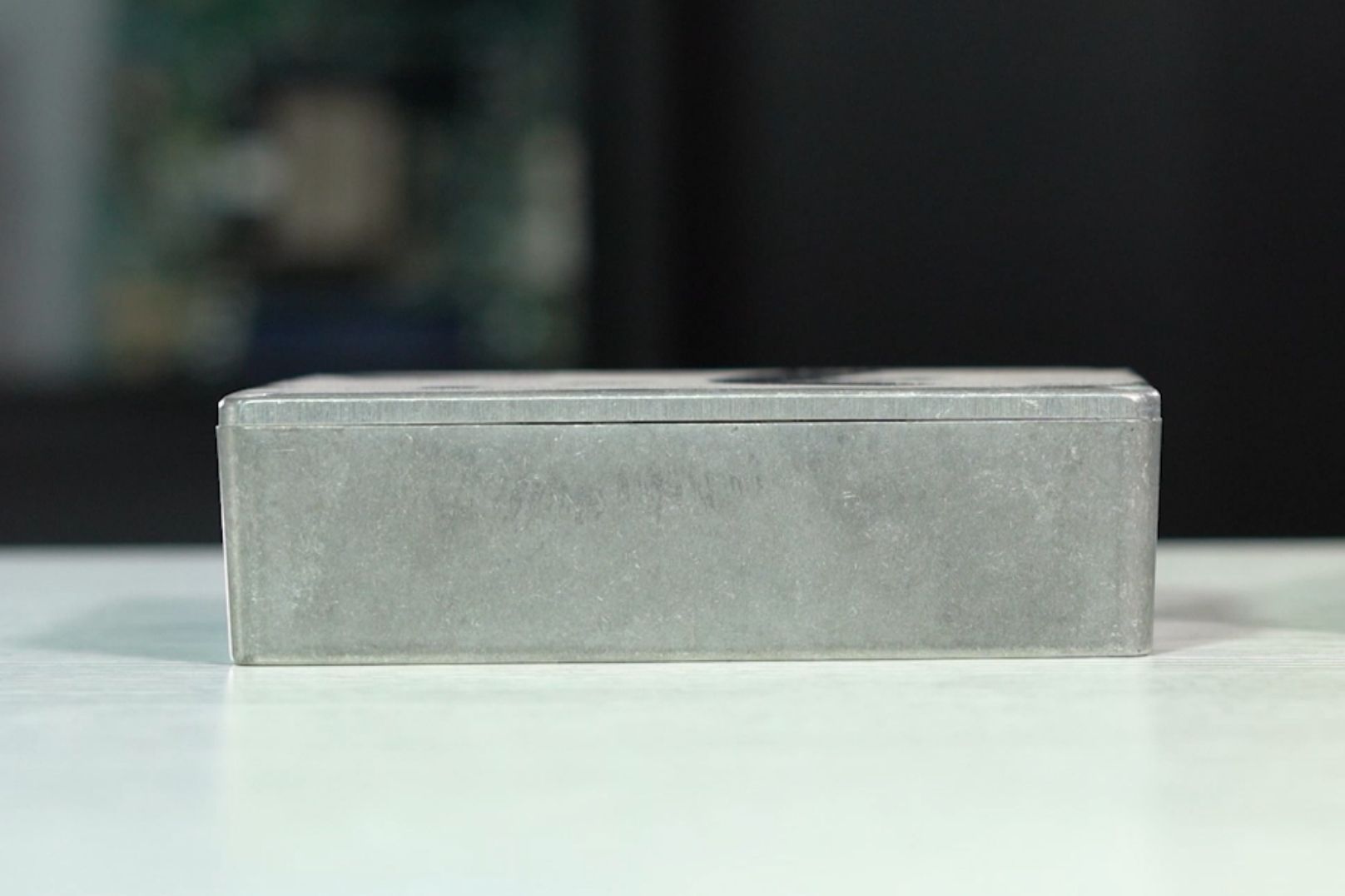

Media Blasting:
Once a part is CNC milled, the part is deburred and then a stream of tiny glass beads is sprayed onto the surface via compressed air. The end result is a bright, more uniform finish.
Things to Consider:
- • Excellent option for removing toolmarks from machined parts.
- • Flat, non-directional finish.
- • Maximum part size is 6”x6”x6” (152.4mm x 152.4mm x 152.4mm)
- • Parts must have a minimum of at least one dimension that exceeds 2”
- • Risk of warpage for thin parts and/or large surface area parts
- • We recommend handling with gloves in order to avoid staining or smudging the parts
- • As media blasting is a manual process, results may vary in terms of uniformity, especially when anodizing will be applied to your media-blasted part
Learn more about Media Blasting.

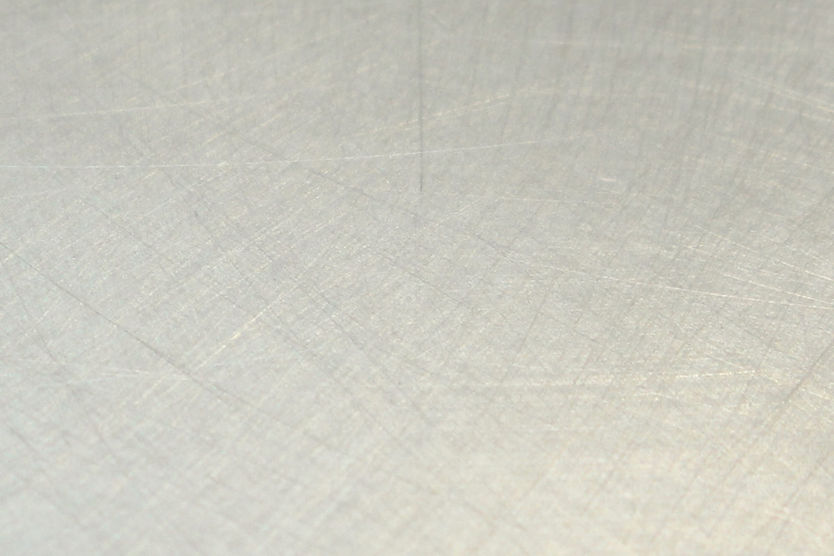

Vibratory Finish:
After milling, parts are processed via a vibratory tumbler in abrasive medium to impart a random (non-directional) matte appearance that is similar to frosted glass.
Things to Consider:
- • Limited to parts 10"L x 10"W x 10"H (254mm x 254mm x 254mm) or smaller
- • Ideal for smoothing over rough edges
- • Vibratory finishing will minimize the appearance of toolmarks, but not completely remove
