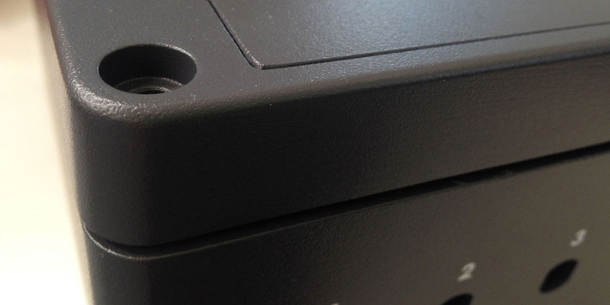

Powdercoat:
					Powdercoat paint is applied using our standard powdercoat procedure. We offer a wide variety of stocked powdercoat colors (and can order non-stock powercoat colors for additional lead time and cost). Powdercoat paint creates a strong finish that is wear-resistant and corrosion-resistant.
Things to Consider:
- • Powdercoat paints with texture (Sandtex Polyester and Textured Polyester) will cover machining toolmarks with no additional finishing operation.
 - • Non-textured powdercoat paints (Smooth Polyester, Smooth Epoxy and Smooth Polyester-Epoxy Blend Hybrid) will not cover toolmarks on their own. We recommend choosing vibratory finish, in order to cover all toolmarks before powdercoat paint is applied.

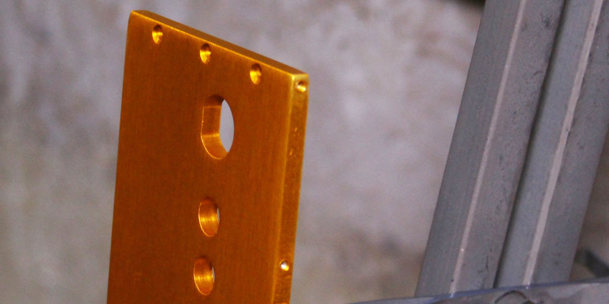

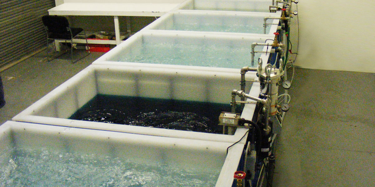

Anodizing:
					Anodizing is an electrochemical process that convers the metal surface (aluminum, most commonly) the metal surface into a decorative, durable, corrosion-resistant, anodic oxide finish.
We offer many color options for anodizing.
Things to Consider:
- • Protocase's Anodizing services are performed externally by a third-party. As a result, there is an additional lead time.
 - • Similar to chem-film coating, anodized parts will show visible toolmarks from the CNC machines' cutters. If you require a uniform finish, please make sure to request either grained finish or vibratory finish before it is anodized.
