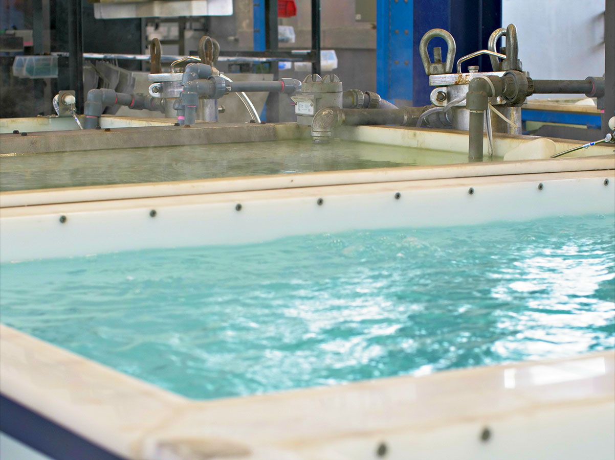

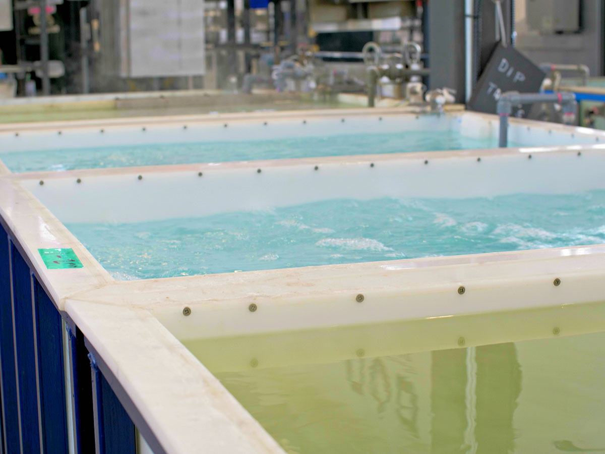

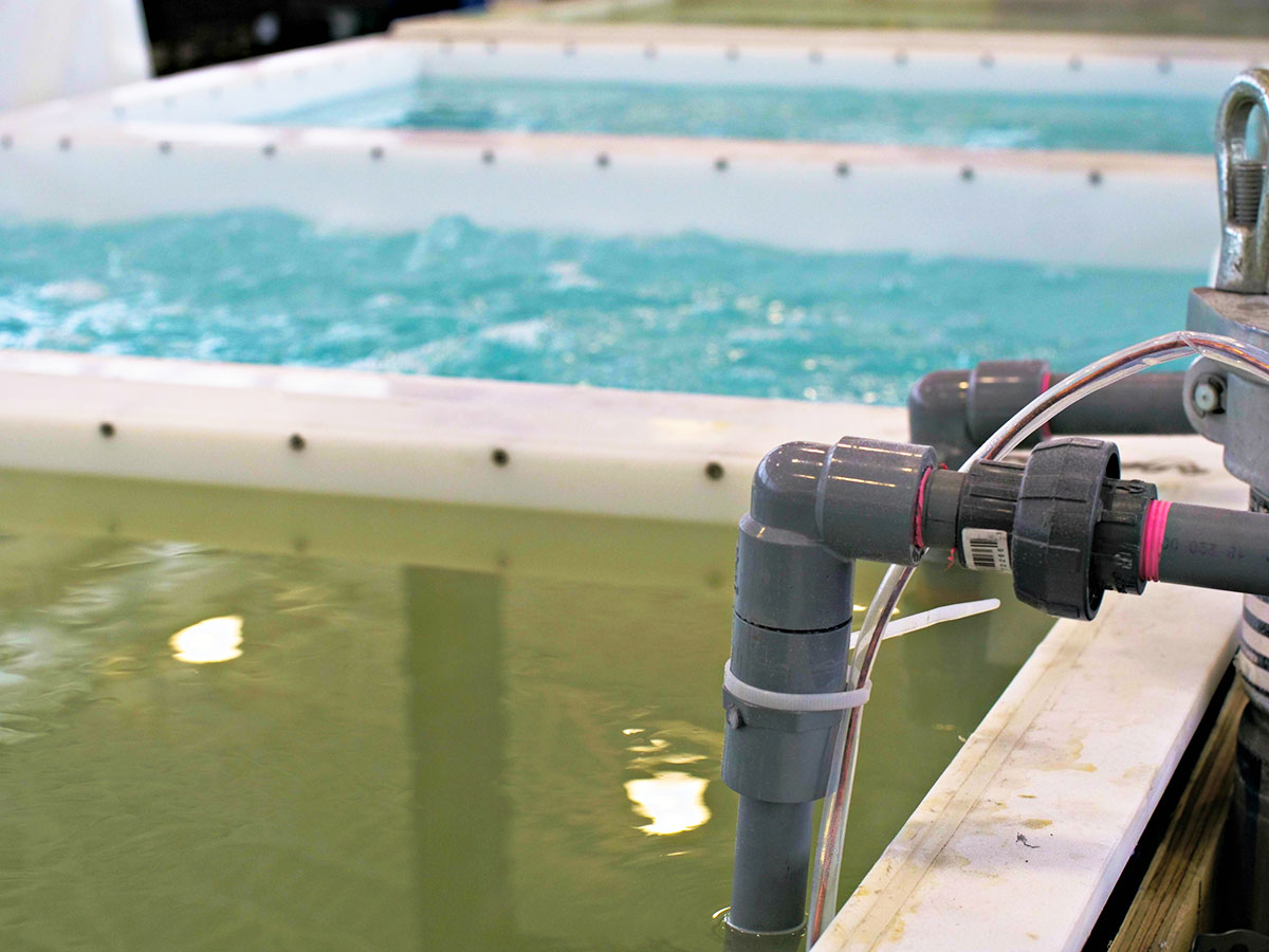

Protocase offers in-house passivation on all enclosures, parts and panels made from stainless steel.
What is Passivation?
Passivation is the process of treating stainless steel with Citric Acid in order to remove free iron from the metal's surface. When the surface iron is removed, a passive surface film comprised of chromium/nickel oxides is applied.
Once the stainless steel is exposed to air, the chromium/nickel oxides react with oxygen to form an oxide layer, protecting the rest of the steel from corrosion.
